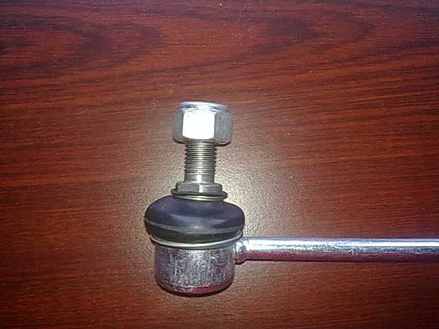

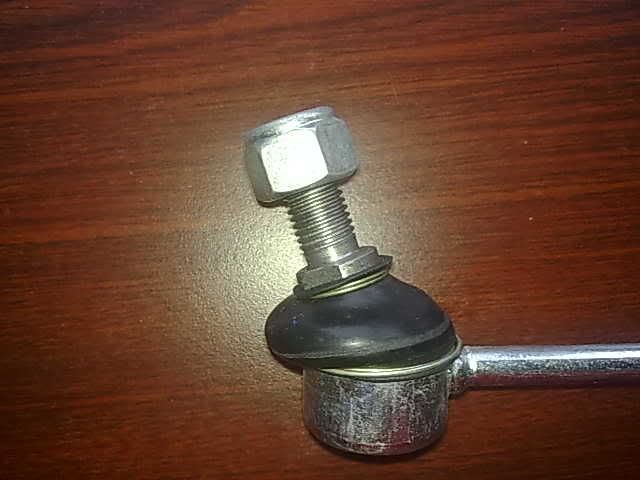

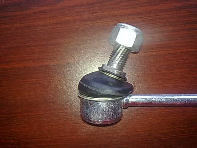

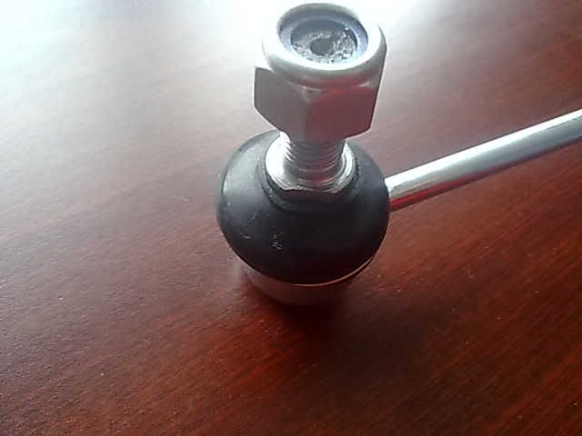

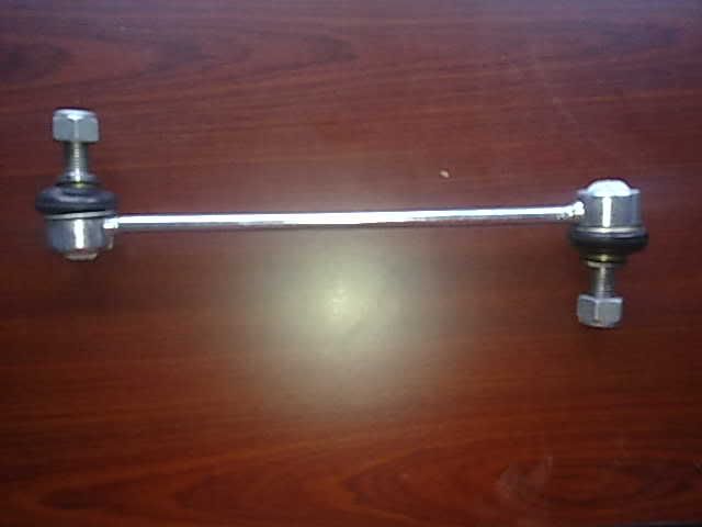

Okay......... well the drop links I purchased are here and the pictures are this...........
As can be seen there is a no problem with the boot being stretched and the inevitable split and the then failure due to moisture ingress....... I would say as good as O.E....
Hope it helps......

That looks a bit better =D> , 12mm thread?
mikexgough
Posts: 6158
Re: Drop links
Post by mikexgough » Mon Feb 22, 2010 1:27 pm
missfixit70 wrote:That looks a bit better =D> , 12mm thread?
Just put the vernier across......... yep 12mm.... :D
Re: Drop links
Post by missfixit70 » Mon Feb 22, 2010 1:34 pm
Getting there then - I must admit I'd still like to see the shoulders on the nuts & not sure if those have the fine pitch thread (to enable better tightening) as per the originals though while we're trying to get this right

I did notice on the ones I got had metal rings retaining the dustcover....rather than a plastic jobby.
The dust cover has plenty of give and is not stretched at all when the joint is moved to it's limits, I wonder how they will weather when fitted.

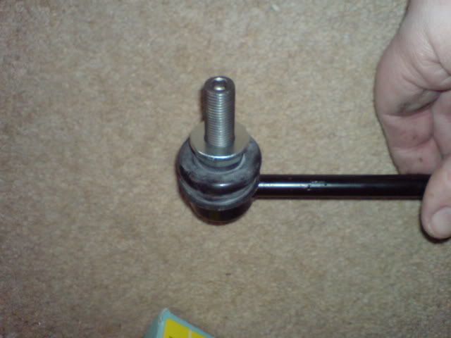

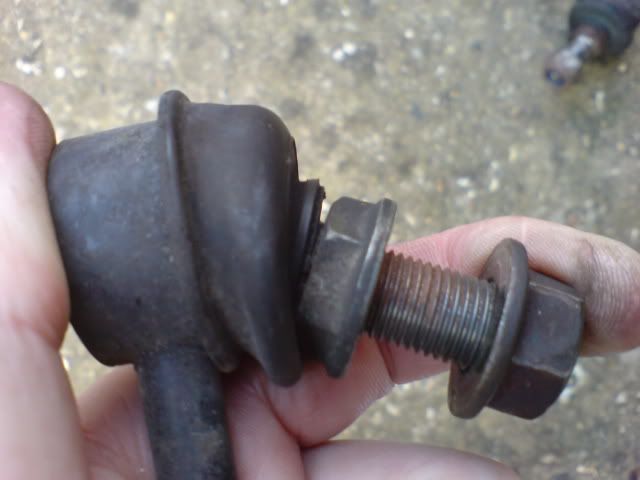

Just received a little parcel from Bongo Towers with a Blueprint droplink sample to compare, very impressed, identical to the original, Nice big chunky rubber boot with no stress at full stretch, plastic type coating on the rod, which is as sturdy as the original, pressed metal casing on the heads, fine pitch thread same as original ( didn't come with securing nuts, so checked it with one from one of my originals) with a shouldered nut on the base & allen key fitting in the end of the thread for fitting & removal.

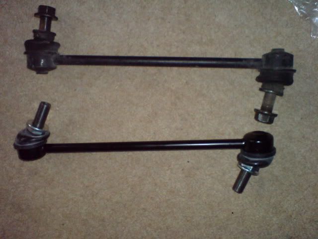

Top one original Mazda, bottom one Blueprint sample

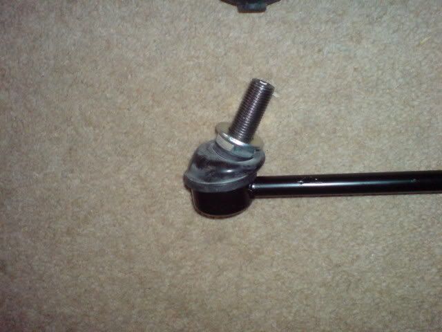

Full stretch, no stress on the rubber
Allen key fitting & showing the boot in "rest position"
Not sure what the price will be on these yet & I'd be happier with new securing nuts being supplied with them, which I'm sure Ian will look at :wink: But bearing in mind I've now replaced my Vectra type ones 3 times in less than 3 years of ownership, it seems a bit of a false economy, I think I'd be happier paying a bit more for something that lasts & is basically the same as original.

missfixit70 wrote:Just received a little parcel from Bongo Towers with a Blueprint droplink sample to compare, very impressed, identical to the original, Nice big chunky rubber boot with no stress at full stretch, plastic type coating on the rod, which is as sturdy as the original, pressed metal casing on the heads, fine pitch thread same as original ( didn't come with securing nuts, so checked it with one from one of my originals) with a shouldered nut on the base & allen key fitting in the end of the thread for fitting & removal.

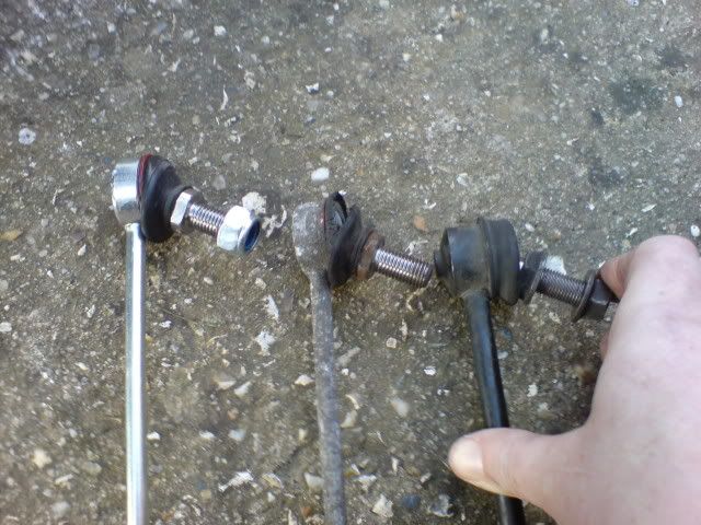

Vectra type ones I'm referring to are the ones that have had the boot fail 3 times previously (see my previous post), the ones that are usually sold on ebay & the ones that Ian is currently stocking, where the boot gets stretched beyond where it should so it fails in less than 12 months (I'm not the only one either).
Not trying to scaremonger or anything, as I'm sure I'll get accused of :wink: but trying to find a fit & forget replacement that'll last a damn sight longer than 12 months.
Where did you get yours from Mike & any idea of make?
If you look at the pic, the first is a brand new one from Ian (same as Jake sells on ebay), the second is the same part after less than 12 months of use, the 3rd is the original Mazda droplink after 13 years fitted, other than the balljoint itself being slightly worn, still looks in very good nick compared to the other one (see the comparisons on my previous post). The sample of the Blueprint droplink is manufactured to the same standard as the original, just read the note properly that came with it, they'll be going out at around £35 plus delivery each, not cheap, but better than replacing every year. Same Blueprint part at my local motor factor was nearly £50 inc vat.
Let's see what the next supplier comes up with :wink:
