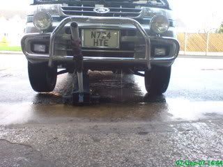

Job number one,deprive my bongo of her lifeblood
My poor bleeding bongo!

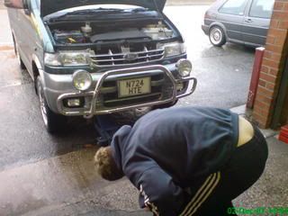

Up onto the ramp....
Let the dirty hands begin... (well, for stu anyway!

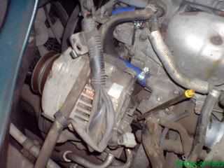

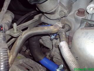

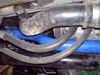

The following pipe near the alternator needs some carefull attention,as you can see from the pic below,the alternator belt has been removed,and the alternator slid as far back on its adjuster as possible,in the future,stu would remove the alternator completely to aid in access,the new silicon hose has the original rubber sleeve re-fitted (heat insulator)
This was the only hose which needed any kind of adjustment,one end of the inner part of the hose needed "reaming" out a smidgin.
I didn't have time to label each pic as i went along (stu was too quick for me)

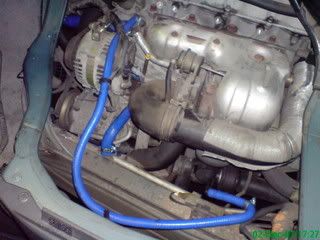

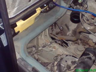

It becomes obvious (even to me) which new hose goes where once the bongo is up in the air.

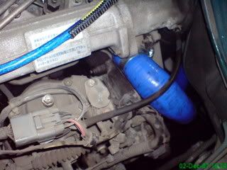

I've been lucky in my four years of ownership in having no issues with the coolant system, but how long was that lucky streak going to last? I'm a big believer in preventative maintenence,so it was natural for me to invest in this kit.
I'm not fully up to scratch with which hose feeds what,but i tried my best to learn as i went along...

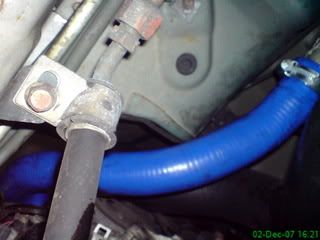

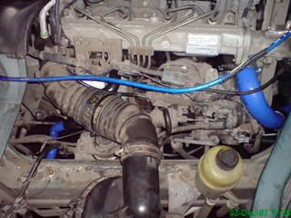

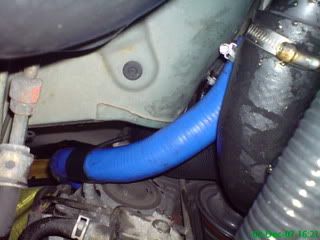

More pics....

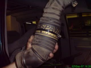

Whilst i was at wheelquick stu pointed out something a little unusual that he's not come across before,mike was summoned, he too had not seen one previously fitted to a bongo....
It appears to be some kind of electronic air flow regulator (a primitive mass air flow meter?) which was plumbed into the air intake system,the device was electronically linked to a little box attached to the top of the right hand side chassis rail.
This could be why i saw such an improvement when i fitted a K&N to my bongo?

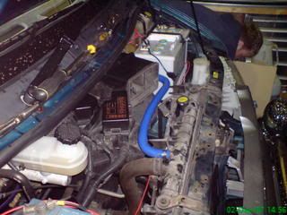

After all the clips were checked,it was time for bleeding...
Wheelquick use a variation of the bigdaddycain hosepipe method,pink longlife coolant was used in my bongo,and before you all jump up and say,"its pointless using longlife coolant,it needs changing annually" It was At hand at the time,meets all the specs,and CAN be used in aluminium engines.

The follow up drive proved uneventful,no gurgling,heaters blowing hot constantly,temp gauge planted firmly at 11 o clock....
The usual "post coolant change" top up was neccessary this morning,(two cupfulls of coolant?) Then the 11 mile school run,in heavy standing traffic,again, no ill effects,no signs of airlocks.... no loss of coolant when checked after cooling down.

Good stuff BDC - one curious observation though.............in the 4th pic (of more pics) it shows the hose under the driver's seat which goes from the cylinder head down to the radiator - this hose looks SWOLLEN like a faulty original one!
Did the manufacturer make the silicom ones as a direct copy of used originals??
