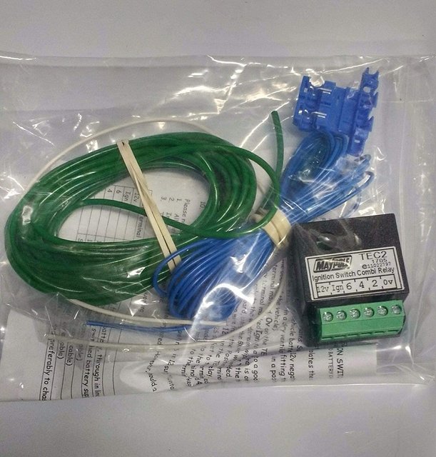

New developments....
Fuse & Relay replacement was needed. Hoping that's the end of it.
I had the new LB fully charged up and ready for a trip and halfway through our trip ,whilst having the inverter switched on (which means the fridge was on) and as we were driving thus there should have been charge coming from the alternator, the whining noise came back on. It stood to reason that the battery exerted all its charge and was not receiving a charge off the alternator.
Bought a caravan fuse kit and just replaced all the fuses in and around the engine bay, like for like, where I specifically noticed the fuse from the live wire on the Starter Battery was a bit 'spent', which could have been my problem, not sure. I also bought the exact same Ignition Switch Combi Relay / Maypole Tec2, which the mechanic fitted wiring it like for like. [https://www.amazon.co.uk/UNIVERSAL-CHAR ... B07P1H93B3]
Took it out for a spin there this weekend, should really have checked all the multi meter stats before, during and after but after the trip, which saw the LB sustain some decent heater usage, the reading on the LB was >12.9v.
One would hope and imagine that the problem has ultimately been solved?
However, whilst on the subject, I wanted to learn more about any one else's recommendations for the best way to split the charge. When I was doing my research on Split Charge Relays etc and how they work - there was some literature on other 'smarter' systems and essentially I want to try and future proof my system because, if its broke down once there's a chance it might happen again and I obviously don't want that.
I have a funny feeling that what's led to this has been the fact I used EHU. Reason being is because the previous owners specifically told me they had never used EHU and only ever wildcamped with no problems. However, first time I used the van, I used it with EHU, until the initial battery (which I replaced) eventually depleted and since I didn't know any better, it remained in a deep state of discharge until I worked out there was a problem (hence this entire thread).
Does anybody know if an EHU is capable of such trickery?

There really isn't any reason why using the EHU would have caused problems, the only thing that is possibly adjustable in a charger plugged into the EHU is its voltage and the range it can be adjusted over (normally an internal adjustment anyway) is limited and well within the range that wouldn't harm the battery.
There are some odd ways that people install split charge relays, usually they don't cause any problems until other faults develop that can make diagnoses difficult.

g8dhe wrote: Mon Feb 21, 2022 10:18 pm There really isn't any reason why using the EHU would have caused problems, the only thing that is possibly adjustable in a charger plugged into the EHU is its voltage and the range it can be adjusted over (normally an internal adjustment anyway) is limited and well within the range that wouldn't harm the battery.
Well, latest update on this, and especially for anyone else's future reference purposes.
Essentially I think I can draw a line under this one and chalk it up to either a bad fuse [between the live of the starter battery and the live of the leisure battery] and / or a burnt out ignition switch relay.
The reasons are because prior to doing this my brand new LB [which was completely charged] fully depleted during a weekend trip and the Waeco PP1002 inverter begun to make its whining noise to let me know the LB was <11.4v.
After making the fixes, I took it out last weekend, albeit, never put the LB under any serious use and whilst I did not take a reading [with my multimeter] before or during my trip, I did take a reading afterwards and it was coming in at 12.9v, which is OK. I left the LB in the engine bay during the week, drove the Bongo about 30km and today I took a reading where both the SB & LB are reading in at approx. 13.7v, which is pretty healthy voltage according to most metrics. Suffice to say that the battery has been taking a charge from the SB/Alternator.
Therefore, I can conclude that the problem has been solved. Since I am planning a trip away this weekend, where I know I'm going to be using the battery quite heavily for the eberspacher heater, I took it out anyway and have plugged it into the wall.
Would you say that's generally good practice anyway or is that overkill?

In fact I took the old battery out and charged it off the wall a few times and TBH, I think it's okay now. It was this little unit which was messing me up:
https://www.amazon.co.uk/gp/product/B07 ... _667574411
The last one was fried and when this was replaced, all was well.
Posts: 10971
Re: Waeco PerfectPower PP1002 Inverter
Post by g8dhe » Sun Jul 03, 2022 9:26 pm
Yes those are intended for caravans, where by your charging the battery in the caravan and possibly running the fridge whilst driving. They rely on the length of wiring from front of the car to the caravan to limit the charging current and then handle the fact that when on-site the car is disconnected and the caravan uses its own battery or its own EHU connection. Whilst in principle this is similar to a campervan its NOT identical, hence the relay is not adequately rated for the charging current and often burns out after a while depending on how much the LB is used etc! There are much better options designed for campervans where the relay is much more adequately rated and doesn't have the need to handle the back of the van being disconnected from the the front seats and engine!
