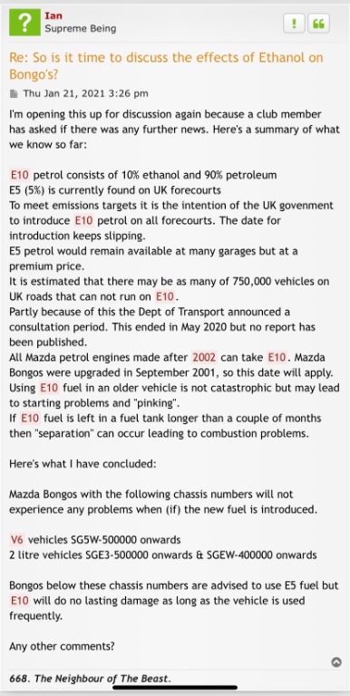

Does this supersede this regarding V6s now? Our chassis number was ok based on the previous info (see attached pic) but now I’m not sure?Ian wrote: Sun Aug 08, 2021 8:24 am The exact wording of the statement issued by the Japanese Association of Automotive Manufacturers on behalf of Mazda states:
"E10 petrol is cleared for use in all models with petrol engines introduced in and from 2002"
The part number for the engine on V6 Bongos did not change between their introduction in May 95 to their demise in August 02. Use E5 fuel where available.
The part number for the 2 litre Bongo changed on 17 July 2002, so if you have a vehicle with chassis number SGEW-503208 onwards, or SGE3-400091 onwards you can use E10 fuel without any problems.

The latest information is correct and supercedes the conclusions reached back in January. V6 Bongos should continue to use E5 fuel where available. This is because, unlike 2 litre versions, no changes were made to the engine etc in 2002.
