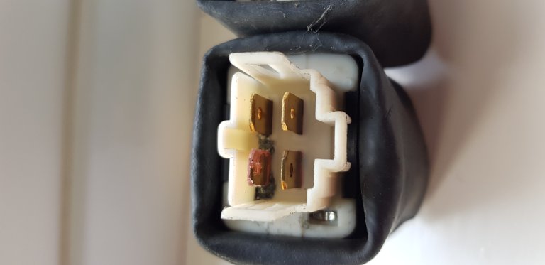

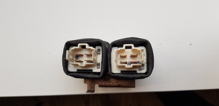

Update..
Well having removed the relay I think my problem is evident, corrosion I believe.
I think my best option is to replace this unit?

Posts: 10846
Re: Clicking from solenoid
Post by g8dhe » Tue Nov 24, 2020 4:20 pm
You will have a problem replacing that loom, just clean up the connectors and a good squirt of contact cleaner before using WD40 before putting the relays back in.
