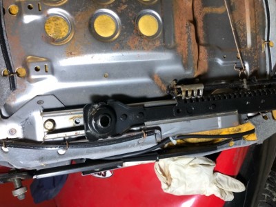

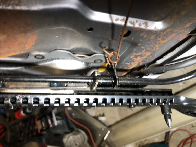

willow2u wrote: Thu Nov 26, 2020 9:09 pm Had a look at the runners I think if the angled ends were chopped and another runner was welded on with about 10mm spacers I think it would work, if I was faced with the same problem that’s what I’d do 8EC2AC34-1E29-4189-BA91-F47756A8548D.jpeg578D1166-4237-4285-9848-3A8C5424021C.jpeg1C6EECBF-4141-4BC3-A43B-94956D84C2EC.jpeg
Thanks Willow. Am i right in thinking the the left of the photo is the front of the seat, looking from undernearneth. Then you are saying to cut the angled runner bit on the right of the pic.
Are you then saying to effectively extend that runner by welding something on the end? or another runner on top?
Don't worry if it hard to explain, as you may have guessed I cant weld so I won't be doing it myself! Although if there is anyone in Bristol who could do it, I could pass on your idea
Also Happy FRIDAY!

In the photos where you see the small connecting wire linking the 2 runners that is the front,chop of the front and rear mounting holes off then weld another pair of runners to those with 10mm spacers in between as a sandwich then you will have the range of the normal runners x same again I think it will raise the seat about 25 to 30mm higher

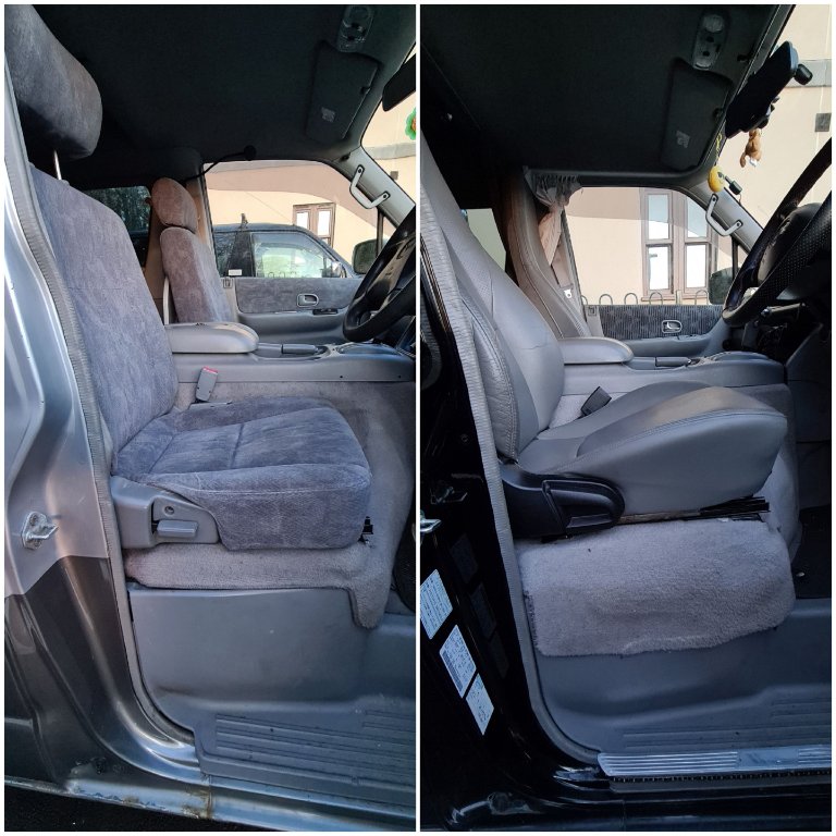

Here is a comparison picture of the MX5 seats and Bongo seats, as you can see your knees are lifted higher by them.

Thanks for the photo of the mx5 seat, my concern with it is getting my knees under the steering wheel. I have fairly chunky legs and it's already a bit of a squeeze!
