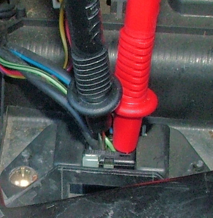

Chief Brody wrote: Wed May 01, 2019 11:12 am Thanks Teenmal. As far as I was aware, after reading threads here, the only way to measure the voltage of the TPS was to do it at the ECU.
Have Look
https://www.youtube.com/watch?v=xIB3H-HqhkE
Posts: 10951
Re: TPS error 12, replace or adjust?
Post by g8dhe » Wed May 01, 2019 2:04 pm
Leave the connector on the ECU and just push a probe up the wire required onto the crimped on terminal pin inside the connector shell.

Post by Chief Brody » Wed May 01, 2019 4:37 pm
Thanks Geoff. I'll try that but I think my probes are a bit too short and thick for that.

Post by Chief Brody » Thu May 02, 2019 9:07 am
Well I managed to get a brief reading from the TPS pin and it was 0.034V which is way under the idle measurement. The reading was very intermittent so who knows. I then went for a drive after adjusting the TPS slightly. I did around 10 miles with no real issues but I've had way more miles than that before the issues start. I just really need to rely on the Bongo a bit more. I'll be doing over 100 miles with it up to Aviemore soon enough. Tempted to fit a new TPS myself just so I know it's done but unsure of how easy it is. Anyone done this on a diesel?
