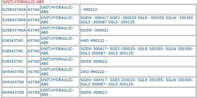

Hi all
Hope it's ok to jump on this thread rather than start a new one on nearly the same question.
Our ABS pump it leaking S38J487AO, I've checked the chassis as suggested which marries up to the code on the actual pump we've taken off the van.
My question is: DOes it HAVE to be the same model or will another with a similar number fit for eg SH54437AO?
Many thanks for any help advice on this, we've bought a fixer upper which is fighting us, but we will win lol
Posts: 10972
Re: Where is my ABS pump?
Post by g8dhe » Sat Sep 20, 2025 12:02 pm
Your much better off starting a new thread to be honest!
As to will a different part number fit, then without comparing the specific specifications impossible to be certain, often most of the pump will be the same but might have a different outlet position or slightly different fixing screw locations, if its from a much later model the differences maybe a lot more extreme.
There seem to be three part numbers quoted depending on model;
https://www.lushprojects.com/bongoparts ... f02.html#8
If you Google the part numbers (accurately its a 0 not an O at the end) then;
https://www.google.com/search?q=SH54437A0
https://www.google.com/search?q=S38J437A0
https://www.google.com/search?q=S25E437A0A
