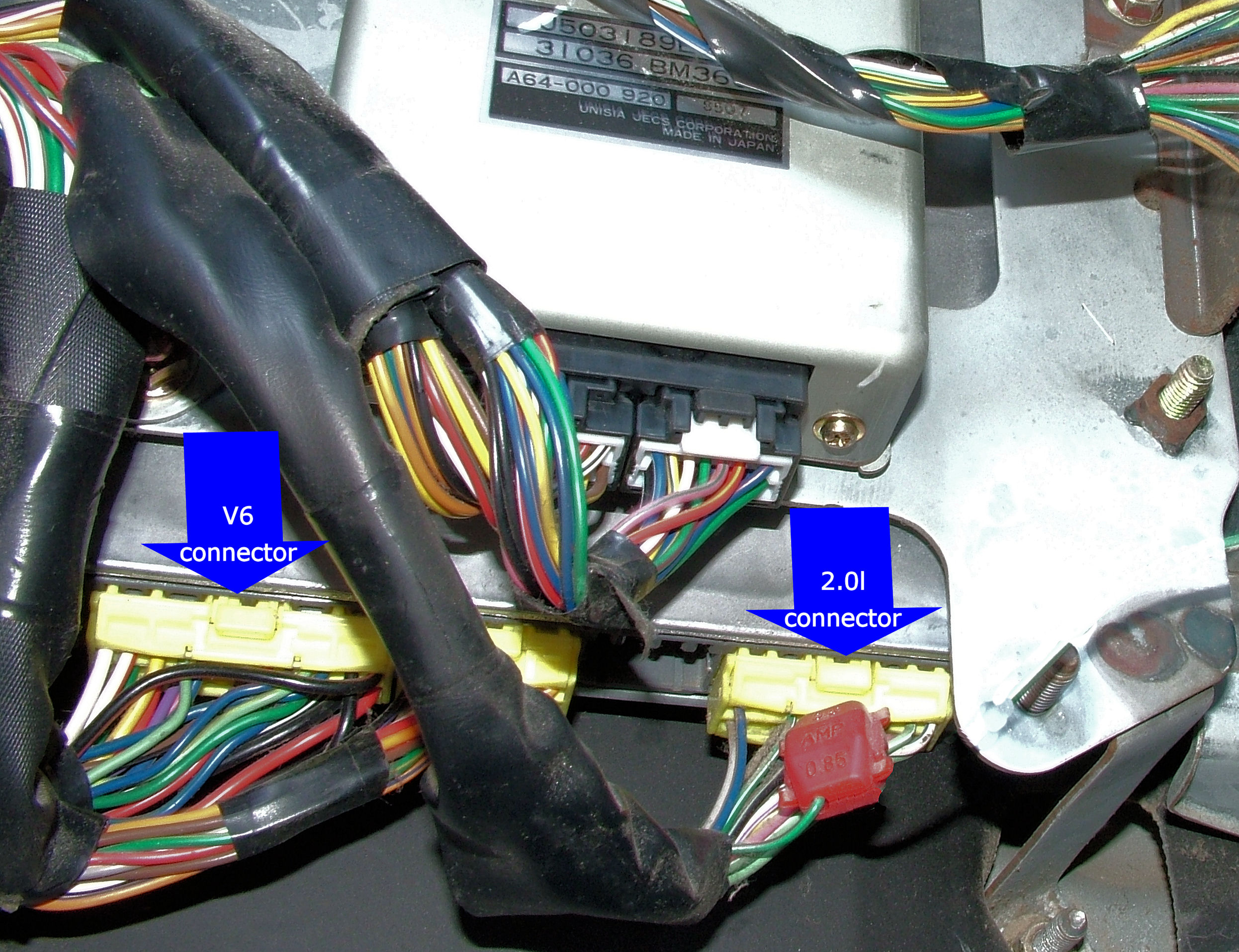

Could I be a real pain and ask for an image of the underside of the plug wiring?
Its the wire colours I need, I can get most of what I need from those.

Does anyone have similar images of the V6 ECU showing the wiring into the plugs?
Ta.

V6 ECU connectors;
MOunted on top of the ECU itself is the ATX computer the TCM.

g8dhe wrote:V6 ECU connectors;
Thanks Geoff but I cannot save the image to enlarge it as it shows as TXT file.
Could you re post?

Post by g8dhe » Mon Feb 20, 2017 2:45 pm
The colour codes and positions are shown in the wiring diagrams if that's what your after ?
See
The full size image is here http://www.g8dhe.net/pictures/cars/Bong ... ectors.jpg
