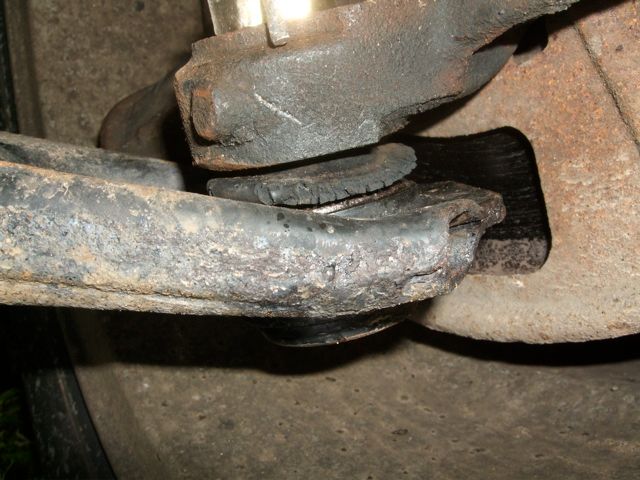

My experience was having brand new rubbers going within weeks (seller A, product X) - these would have allowed dirt ingress very quickly which would quite easily cause the joint to fail within the first year.
The solution for me was to fit aftermarket replacement rubber boots provided by the supplier at no cost, and in my opinion far better suited to compression within the limited space between wishbone and knuckle - there is NO WAY the particular rubbers that came with the my replacement ball joints were supposed to compress the way they did.
So either I have an oversized taper in the knuckle or something, or the shape of boot on the supplied ball joint was incorrect for the application.
It makes me wonder whether, for many of the <1year ball joint failures, "it's all in the boot"...??
Picture below - rubber after two weeks and a couple of hundred miles...
Just for the sake of illustration (no relationship to the sellers, parts, quality, etc...)

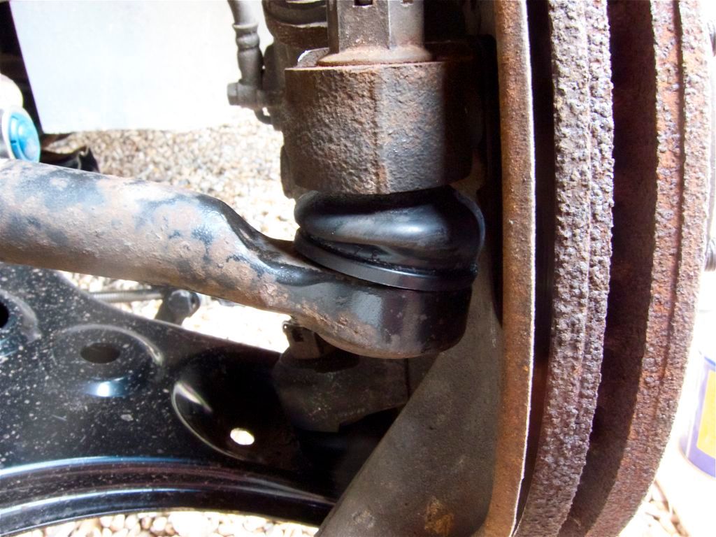

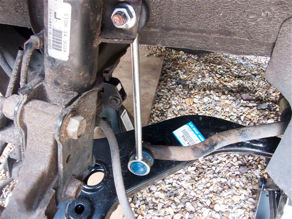

Right, all done! New wishbones, drop links and track rod end boots. Partial MOT retest is booked for tomorrow afternoon. Fingers crossed that it now passes!
New Mazda wishbones and Meyle HD drop links.
New boots for the track rod ends.

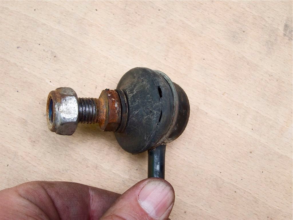

Here is an old eBay drop link that had been on for just 4 months. You can see the holes.

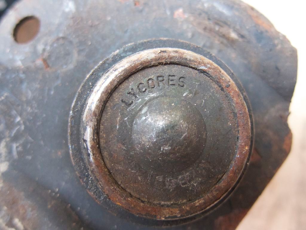

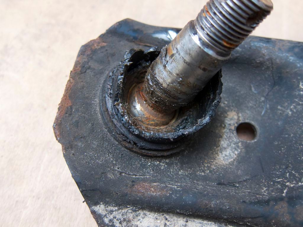

And one of the eBay lower suspension joints that lasted barely 12 months. I utterly wrecked the boot getting the joint to separate, but you can see the rust inside the joint, and it flops around quite loosely.
