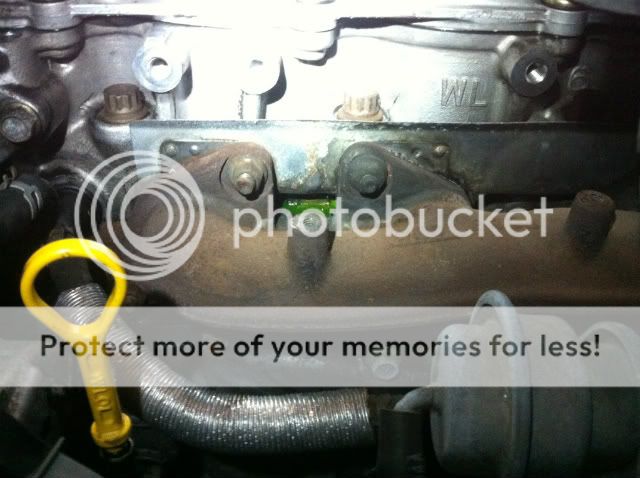

teenmal wrote:Hi Nippon Tuck,
A strong possibility is a leaking Core Plug.
Cheers.
That passed throuh my mind too.
Steve

ive just had a look at a spare head (under the bed) , if its a gen mazda head, which it looks like it is, there is a core plug between exhaust out 1 and 2. and one between 3 and 4, but not one between 2 and 3.
the first picture shows the leakaround port 2 so its possible
Cheers.
As I traced the leak up from the tray yesterday, my sense of panic at the coolant I pictured, made me run for help. :oops:
Thanks to your suggestin teenmal, I had another look and......... HOW THE DEVIL DID I MISS THIS?
BONGOFURY TO THE RESCUE!! =D> =D> =D> =D> =D>
BRILLIANT. Now. That looks a whole lot cheaper than a head gasket.
Can someone advise the part and expected cost, please.
I love this forum.
=D> =D> =D> =D> =D>

Hi,the part No is 993062000 sealing cap/core plug/etc its called a lot of names.
These cost approx £1.00--£2.00 each,best to buy from a Mazda dealer in order to get the correct profile.
