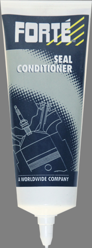

g8dhe wrote:Its just that the one in the link appears to have a nozzle like a silicone filler type as though its to be injected/spread around the seal, rather than a liquid to be poured in to the oil itself ?
Hi Geoff,these Forte products are excellent,always worth a go.
Is the filler that you are looking at in the pic a spark plug??
Cheers.
Posts: 10949
Re: V6 Cam shaft seals & Crankshaft seal ?
Post by g8dhe » Fri Feb 10, 2012 6:28 pm
Nope it was this one;
But I see now as the tube only holds 125ml its quite small.

Right well none of the local motor factors had any in so a couple of tubes have been ordered from Ebay, if the first one does the job, then I'll bring the spare one along to the Bash to sell onto someone else ;-) However I may still have the seals changed depending on how much it might cost!

Right the deed is done, 125ml squirted in, the PCV checked and operates fine. Now just to give it a run and see how things change over the next month or so.

So far the the Forte seems to have done the job, it took a week or so to have an effect, but the last couple of times it has stood out on the road we haven't so far spotted any drips [-o< we will see how it performs in the next three weeks as it will have travelled up North and been standing on the same spot overnight for a week so we should be able to tell quite accurately ...

Well still working fine as of today, no further drips at all and even the smell of hot oil seems to have been reduced where it ran down the length of the engine and dripped onto the exhaust. It hasn't done as many miles as we would have expected so far this year due too the lack of Summer, but that is about to be corrected ... to some extent, with the National Bash looming!

Right just an update it looks like we are beginning to use / drip oil again, so its worked for abut 9 months, so whilst I'll stick another tubes worth in I must now get round to having the seals replaced I think! Its also done the mileage for the cam belt so no excuses this time !
