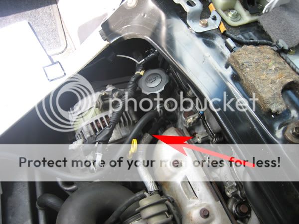

M 80NGO wrote:Not gonna get into a argument with anyone DWH so until i pop the seats up tomorrow and have a look we'll have to agree to dissagree but on any of the turbo's i've removed and replace over the years i can't recall a coolant feed, but after i've had a look tomorrow if i'm wrong i'll gladly say i am ( albeit in very small writing :lol: )
As dandy says, there is a coolant pipe to the turbo (on the 2.5 diesel) - see attached pic - red arrow.
Steve

well as i said earlier if i'm wrong then i'm wrong so oppologies to dwh for doubting his knowledge, i just musn't have ever removed a liquid cooled unit, back in the 80s/90s when we were wraggin the poop oua RS Turbo's R5 Turbo's etc i remember them glowing white hot after a really good wragging and thought that the bongo being from the same sort of era that they would be a similar set up, i stand before you a corrected and more knowledgable person :wink:
