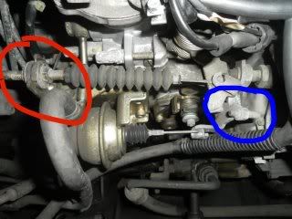

it sounds like you have the cable out of adjustment somewhere, or the diaphram opererated linkages, operated via the solenoids. these new plugs were poss ok, but did you test them first. and did you test the old ones you took out.
if you follow the line from the throttle cable adjuster to the end of the throttle cable the end comes to rest on a brass coloured ball type plunger thingy, it has 2 wires going to it that run forward towards the belts.
if someone could post a lushy pic i could give you the part number to locate its position.
to be honest i dont know what it is or what its called, but it must be pushed in when on rest/tickover, and let out when running.

Northern Bongolow wrote:it sounds like you have the cable out of adjustment somewhere, or the diaphram opererated linkages, operated via the solenoids. these new plugs were poss ok, but did you test them first. and did you test the old ones you took out.
Thanx buddy thats a fairly good description of what i need to look for, yes i checked the plugs whilst in the rail on my bench prior to fitting with the aid of a jump pack and they're all glowing, the old ones were also glowing when i tested them but as this cured the problem 18 months ago i just assumed ( ASS out of U and ME ) that they were weakening, leave it with me i will triumphant and not beaten by the lumpy smokey start up gremlin that has temporarily possesed my beautiful l'oreal

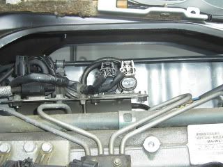

Pete, you don't/didn't have one of those "winter pack" northern Japan cold start jobbies fitted do you....
I have a possible comment to make about the.....
vacuum solenoids too, & this "actuator injection pump"..? http://lushprojects.com/bongopartsmk2/c ... o=.html#18
plus the adjustment of 24-173A
but don't want to cover old ground on that one..!!! (Ady!!?)
I will ask are you sure both vacuum solenoids are working & all hose work is intact.. No hose connectors broken off the solenoids???

Jaylee yes she is a northern girl complete with winter pack but i never use it, its like the pics you posted up with solenoids and actuator, all the pipes are in good condition a couple have been replaced at some point with what looks like fuel hose rubber internal with cloth braided outer
