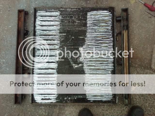

it weighed a ton, and was full of brown flakey particles, so me being a tight arse i thought i would try to clean it out and keep it for an emergency spare.
so i mixed up a solution of household caustic soda crystals and water,and poured it into the plugged up rad. lots of the crud came out. so me being me repeated the proccess, then the phone rang-----------as it was soaking.---------how was i supposed to know caustic attacks ally :oops: :oops: :oops: .
result, one leaking cored rad.
so i took the tank off, top and bottom, and examined the oil cooler, only to find lots of crud still in the rad.
im affraid i cannot tell you where the crud was worse as i had dislodged most of it in the proccess.
parts available to view though if you are passing.
gives off hydrogen flamable gas aparantly too :oops:

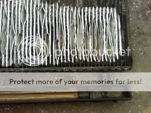

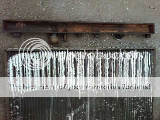

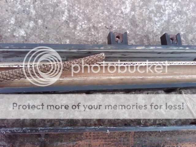

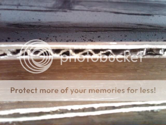

Ady
I think these are the pics you took of the rad you 'cleaned' (in no particular order - sorry)
Steve

Very interesting to see the construction of the ATF cooler there. When I changed my fluid a while ago, it took a serious amount of blowing to get it to flow through. About 30psi on the air line. I was a bit concerned about it being fragile, but it looks reasonably sturdy when you see it dissected.
Image...Image

Nice pics. of the radiator by the way, was there any crud still up the tubes?
