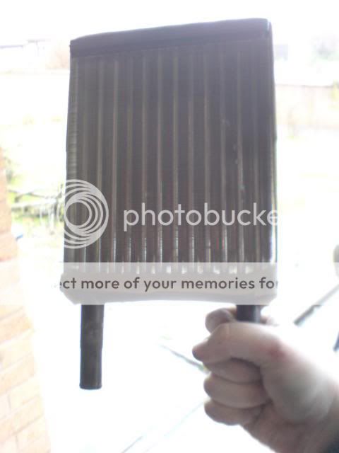

Rear heater is definitely S54N61A10 61A10 CORE,HEATER UNIT
Kirstys rear heater matrix (now with Northernbongalow)
Last edited by widdowson2008 on Thu Feb 17, 2011 9:28 am, edited 2 times in total.

I have our old heater matrix in my garage, but I intend to get it refurbished (just in case), so sorry its not up as a doner either. Bongobits got me a price for a new unit when ours went, but from recollection it was in the order of £300, so I went for the less expensive option of a doner unit. I think in our case the cause of the problem was the extreme cold (-20 temps.... prolonged) and the van had been allowed to sit for a few weeks without turning a wheel. This year I just went for a play in the snow now and again to keep it all warm..... which was much more fun. The weak link in the component is the plastic end caps. I wonder if there is an alternative way to make them? For my money the other week link is the fact that you need to remove the entire unit and the internal panel. It would be a much quicker fix if it was accessible from the inder side. :roll:

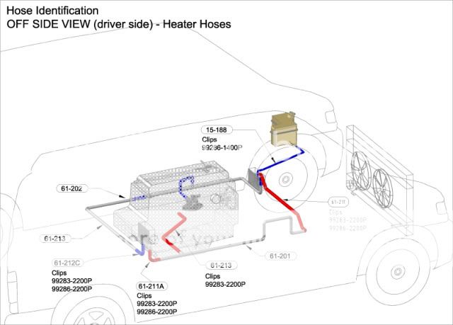

froghandler wrote:Hello All
From looking at the schematic diagram on the fact sheet I think that it may be 61-211A the drivers side heater supply pipe to heater pipe? Does this sound about right? I know it's difficult without a picture.
Diagramatic of heater hoses - Far side
Wrong diagram - sorry. Rear heater hoses connect at the BOTTOM of heater, NOT the side

Although we get cold over here, I had rather thought that it's just age, and constant heating and cooling, as the broken stubs look crystalline like broken bakelite, suggesting a gradual degradation of the plastic. I had both front and rear matrices fail within 7 months, and I did the front, and the rear is to be done. I rather favour getting an all- metal one, and that comes down to weighing up cost/ reliability...I just can't justify replacing it with a plastic one here...breakdown services are appalling!
