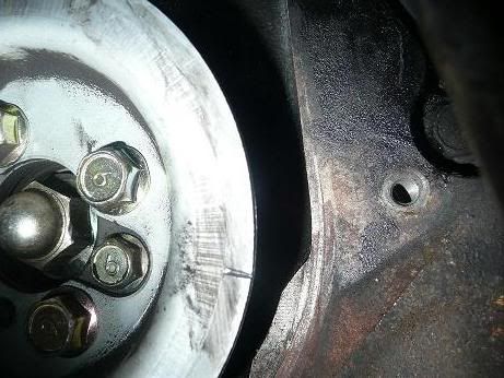

Here's a photo of the pump pulley. Looks like it's not quite right, any thoughts?

If I'm reading your updates correctly - you had black smoke, and now have grey smoke. All that has fundamentally changed is the pump timing and the EGR has been blanked off?
Black smoke is unburnt fuel, which could be an injection timing issue. Grey is usually an injection timing issue, or incorrect fuel.
Sounds to me like you have narrowed it down to a timing issue, but are not quite there yet. Has the situation with the pump pulley changed since the photo you posted on Sunday, with the timing mark at the end of the range?
No change on the pulley but the guy that adjused the pump timing yesterday seems to have gone from one extreme (black smoke) to the other extreme (grey smoke). I think that this suggests that the coarse timing adjustment is not affecting things, or am I taking a too simplistic view on things :?
