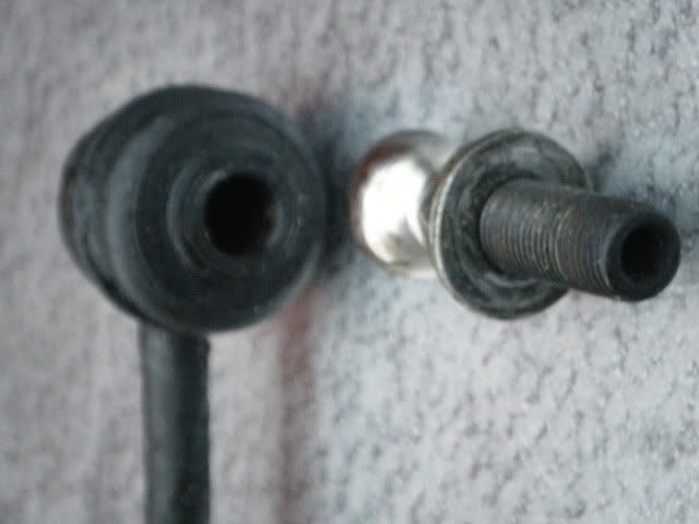

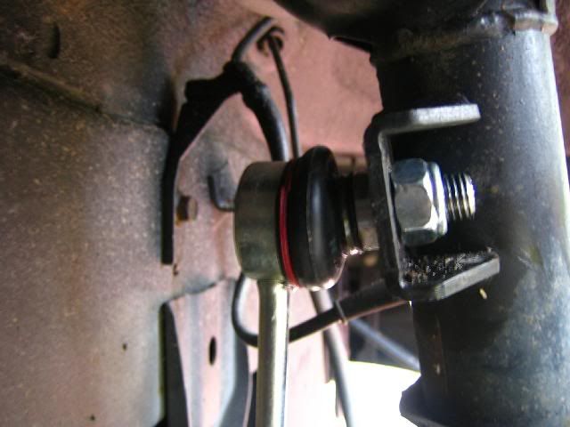

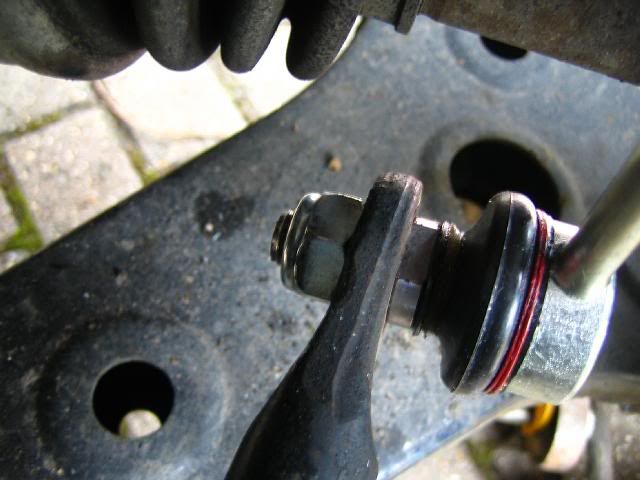

After enquiring as to the dimensions of the parts http://cgi.ebay.co.uk/ws/eBayISAPI.dll? ... 0364262988 supplied by http://stores.shop.ebay.co.uk/JTM-Motor ... QQ_armrsZ1, Jake sent me a sample, and here's how it compares:
I can't vouch for the longevity of such a part, but the fitment looks pretty much comparable to the stock item.
Gareth.
+ Anyone else run with these particular parts for any length of time ?

Post by mikeonb4c » Sun Feb 14, 2010 11:51 am
I don't know which is what in those pics but my Vectra ones had a slimmer shaft than the originals. It's not been a problem and I can't help feel the real deciding factor in practice is whether the bush assemblies at the ends are sufficiently durable.
Interestingly, when I took my old ones off, one of them already had a slimmer shaft than the other :roll:
grb
Re: Drop links
Post by grb » Sun Feb 14, 2010 2:31 pm
mikeonb4c wrote:I don't know which is what in those pics
shiny = new
rusty = old
:wink:
Gareth.

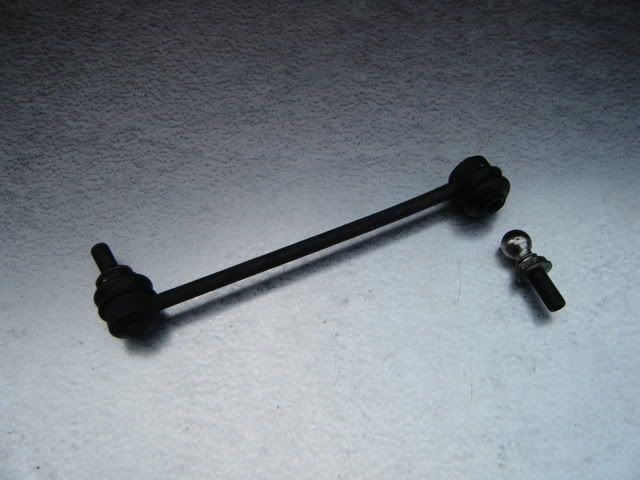

This is the guy that supplied the parts that failed twice on me in less than a year each time - the rubber (which I described as a gaiter Mike as it covers the joint) perishes in no time. The rubber on the original ones I took off was still intact, just the joint had worn after 13 years.

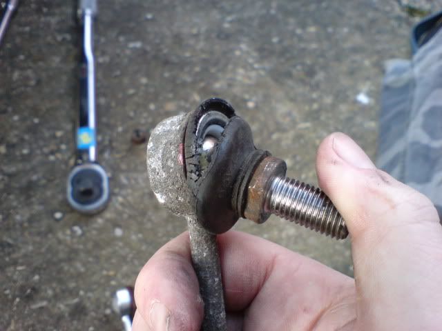

thepickles wrote:How do you know when they need replacing :?: :?: :?:
You'll see the rubber perish which allows crap into the joint and/or you'll get a knocking noise going over bumps as the joint loosens. If it gets too loose this happens (courtesy of Freewheeler)
I think these were the originals after about 12 years, just fell apart in his hands.

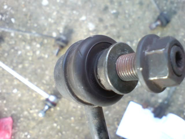

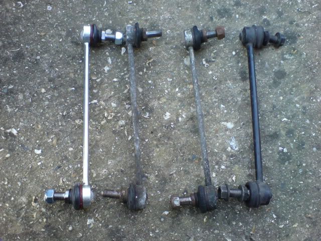

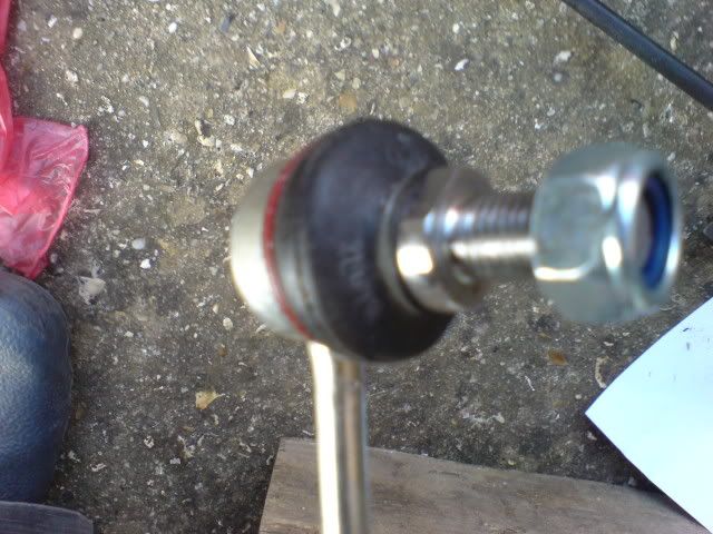

Right, I got a pair of fronts from Ian today, they're the exactly same ones that Jake was supplying & I had 2 sets fail within 2 years, so I dug out my old original OEM ones that I took off a couple of years ago, very different in construction, as already said, finer pitch thread, shouldered nuts on both sides to clamp it up, sealed metal casing & thicker shaft, but the crucial difference is the rubber gaiter/boot that is the point that keeps failing on the cheaper replacement parts. When they are stretched to the fullest extent & have the rubber boot tightly stretched, there is too much strain on it IMO, leading to premature failure of the boot (on the cheaper ones) I think these are the Vectra droplinks that are designed for a different vehicle with less travel needed.
When compared to the OEM droplinks, when they are at "full stretch" the boot isn't under any strain, there is much more rubber available to take up the slack, the OEM 15 year old droplinks had no problems with the boot, it was the joint that was worn.
Newest to oldest left to right
New one, removed one & OEM old one at full stretch, the OEM one's boot got pushed back a bit as I was trying to clean it off to get a serial number
New (vectra/cheaper) pattern one at full stretch, straining the rubber boot

Removed (2 years ago - loose joint) OEM NGK (orginal fitment - 13 years old) at fullstretch - no strain on boot
New pattern (vectra/cheaper) replacement showing boot "at rest" - no real available "slack" to allow movement without straining the rubber
