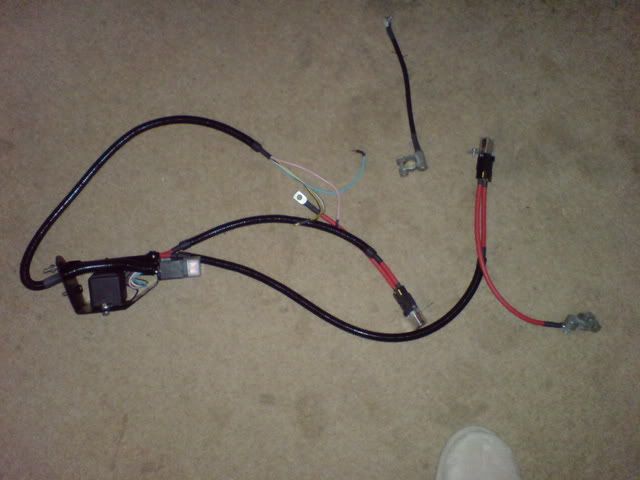

MountainGoat wrote:Sorry Ron, no offence intended but my question was aimed at others to suggest a possible alternative explanation. At the time Dandy fully explained to me what he believed the problem was with my Bongo. At some later date he posted this eplanation on the Forum on one of the many times that this problem has arisen. What he said is as follows:
Jim, I think what Tony's alluding to is that the Bongo alternator doesn't like being tapped into for a split charge relay which is what his converter had done. The heavy duty "intelligent" relays work far better although mine packed in under high temperatures in East Europe this year

I had only had my Bongo about two months before I set off on holiday in it. Before I did so I took it round to my local auto electricians where they spent a day having a look at it, charged me £115.00 then told me that it should be ok. Five days later it failed to start again and needed a jump start. Looks like my auto electricians did not have a clue about split charging and just charged up my battery, That was a really expensive charge up, to think I could have got the breakdown out for nothing. After a month or two of my Bongo being stuck on my drive I got to know dandy and he agreed to have a look at my Bongo for me. He even showed me how to use a multimeter.
