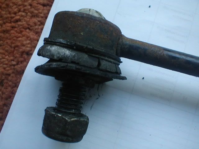

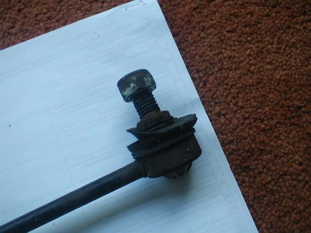

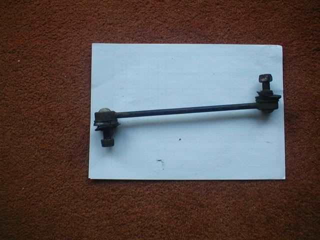

Post by ronhud » Sat Jan 24, 2009 3:24 pm
Just fitted the replacement - went for Vectra again. 30 minutes from start to finish. Photolinks for the failed drop link, the bottom joint still feels ok but the top joint is very loose. My son thinks it is the poor roads round here, I think that may be part of the reason and perhaps the extra weight of the Freda as opposed to a Vectra may count.
Now the chattering has gone but ......oh dear what is that noise from the back end? Start of the back ones going perhaps!!
