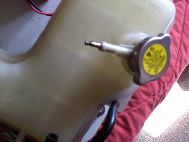

Had a look in more detail at the pressure tester. It looks like that one on ebay has a specific fitting for Land Rover etc. There are universal kits available, but they are £150+. If its just a question of adding pressure via a one way valve & monitoring the pressure, then it should be possible to knock something up with a foot fump, gauge & some means of making a seal over the top of the expansion tank in place of the cap. I'll see what I have lying around the shed.

An easy way to get loads of pressure into the cooling system.
Get a high pressure valve out of a old pushbike innertube. Put a littie epoxy round the thread and it will screw in nicely cutting it's own thread.
When you have finished messing about it can be removed with a pair of pliers. Pump it up with a pump with a gauge on. Normal pressure in the tank is around 13psi.
