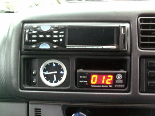

The problem with the Bongo temp sensor in the cylinder head is, that it has to be immersed in coolant to work. When a head or head gasket blows the coolant can be forced away from the sensor and back to the header tank. This makes the temp gauge useless.(and anything dependant on it)
The only way to know whats going on in this case is a cylinder head temp sensor such as the TM2 Watchdog. Only from Oz and around £90+ by the time you get it delivered.
I fitted one of these when I was developing the Coolant Loss Alarm so I would understand a little better what was going on when I simulated burst hoses.
What I did learn was that you can never be 100% sure how the cooling system would react to various induced faults.
I'm afraid it's a case of "you pays yer money and takes yer chance" You can never be sure you have covered all the bases.

Post by haydn callow » Wed Mar 05, 2008 6:58 pm
This is a TM2 Temp gauge and Alarm. You can also wire it so it Alarms when the oil warning light comes on.
