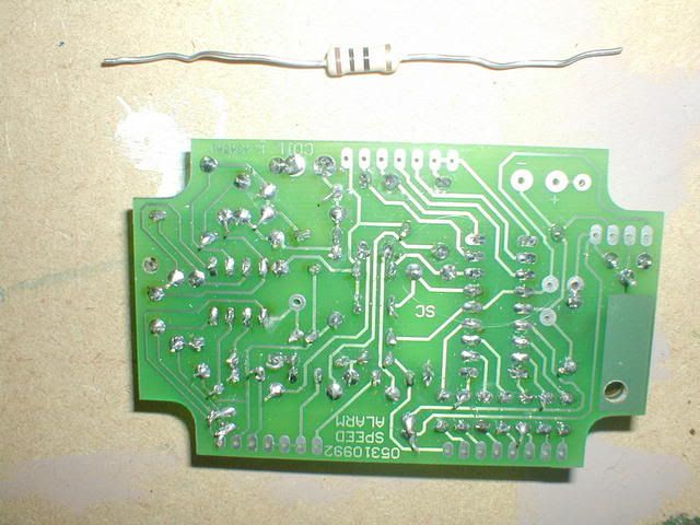

Latest on the speed alert. I have received the kit and after a bit of soldering practice started to build the boards. However.... there is a resistor to mount and the wires from the resistor are too thick to go through the holes on the PCB. Most of the resistors have quite thin wires and don't present a problem and the board does have holes of differing diameters - it's just that the holes provided for this resistor which is bigger than the others are the small size. Can any electronically skilled person tell me whether it is ok to open up the holes in the PCB and if so what is the best way to do it. Obviously I dont want to damage this purpose made board.

moonshine
Post by moonshine » Sun Feb 10, 2008 4:44 pm
Without seeing the back of the board it is very difficult to say. However, I can't see any problem with opening up the holes using a very fine drill, as long as there is sufficient space between the tracks on the circuit board to allow you to do so without infringing on an adjacent track.

Thanks moonshine. Photo below. One leg of the resistor goes into the hole at the top right corner (next to the one with the + sign). The other leg goes into the hole immediately below it. Even the smallest drill I have and it is v small is bigger than I feel comfortable with. One thing I'm a bit concerned about is the pad of metal round the hole might be torn away by the flute of the drill. I've tentatively tried pushing away with the tip of a bradawl hoping that I might sort of squeeze it a bit wider but no luck! The kit came from a co in Australia and I've emailed them re the problem but I would prefer to get on with it now if I can. It may be a simple solution like getting a resistor with thinner legs but in spite of googling I've had little success in finding suppliers to approach.
Maplins do resistors but I would be better taking the board in somewhere so that I cn be sure I get the right part.

Electronics and me dont mix :shock: but the colour coding on it will tell them all they need to know..........i think.
Instead of trying to open up the holes why not reduce the wire size, file or emery it?
moonshine
Post by moonshine » Sun Feb 10, 2008 11:33 pm
Looks to me that there is plenty of room to enlarge the holes. You will only need a drill fractionally bigger than the existing hole. Don't drill from the top of the board, or when the drill breaks through you may dislodge the track. Drill carefully from the underside of the board (where the tracks are) and you should be fine.
In the very unlikely event that you do dislodge the pad or track, you could easily repair it by carefully soldering some fine tinned copper wire along the track.
