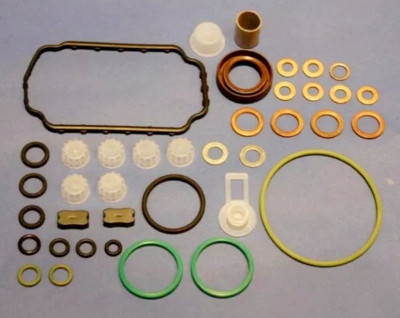

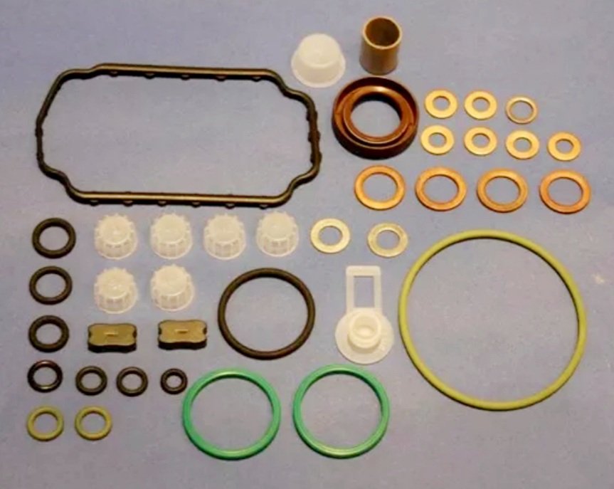

As an update to Dandys great post on replacing these seals. These are the ones that commonly leak.
A word of caution, around 30-40% of the time, other seals fail after replacing these. But that does mean 60-70% of the time, they don't.
You can now buy a couple of different seal kits from Bongo Land
https://bongoland.co.uk/
Replace the seals mentioned in Dandys post.
Or replace this lot! You remove the pump to do this. Keep the work area spotlessly clean. I recommend placing all parts methodically in a tray or container.
Here's the seals you can replace if you remove the pump.
Diesel pump seals
Diesel pump seals
