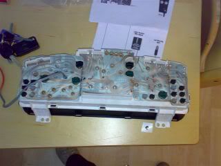

The best route to a solution is if someone can lend me a temp gauge instrument and a sender unit from the head to measure their characteristics.
The next option would be to identify a co-operative owner who lives near me in West Sussex and who knows how to access the back of the instrument panel.
I could then build a prototype for anyone to test provided they can find where to connect it - anyone got a photo of the back of that part of the instrument panel?

Voila Dave:

oh btw Dave, the grey wire coming out of the back of the panel is non-standard, this runs to the LED retrofitted next to the temp guage as part of the famous 'Callow' coolant loss alarm

Are these three screws the terminals for the temp gauge?
Someone will need to identify which is V+, which is 0V, and which is the junction of the sender and the instrument - which in a Toyota would be marked "TU" for Temperature Unit.

Dave Mason wrote:Are these three screws the terminals for the temp gauge?
the left hand screw is marked t-u the top ign and the bottom one e

So this (pic below) is how you would connect the three wires to fit a Mason Alarm.
I can supply ONE prototype with some extra internal adjustments for some brave Bongo owner to buy (£27, same as for Aces and Estimas) and connect to the back of your instrument panel, and then I'll provide advice about how to adjust it based on what results you get. If we can't make it work, return it and I'lll refund what you paid. Assuming it works I can then make a Bongo version based on what is learned from the prototype.
