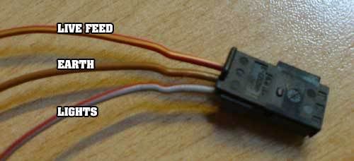

Thanks to Haydn I am now the proud owner of a loverllllly clock complete with metal dial and all the wires (which my last one didnt had)
Not that the wires makes amy difference because I havent a clue where they go...
I have read the superb instruction link...but the wires are still different to mine...
I bought the blue connectors...what oh what am I doing wrong...
My wires are Black, Red and Green
Hubby and I are falling out big style!!!!!
I will post some piccies to explain...
http://s206.photobucket.com/albums/bb19 ... 110021.jpg
http://s206.photobucket.com/albums/bb19 ... 110019.jpg
http://s206.photobucket.com/albums/bb19 ... 110018.jpg
haydn callow
Posts: 5778
Location: Somerset
Post by haydn callow » Sat Jul 28, 2007 10:26 pm
The colours of the wires attached to your clock mean nothing to anyone except me and you. The label attached to the clock explains all.
Connect the green wire to any earth wire or point in the car....Connect the red wire to any permanantly live connection (your radio should have one, if not go to the fuse box or ignition switch......black wire to a sidelight or dashlight feed.
To work this out you may need to use a voltmeter.
You could run the red wire to your battery positive terminal but make sure you put a inline fuse in.
Hope this helps.
The red wire feeds the clock
black wire feeds the light
green wire to earth
(NOTE I did a few clocks with different feed colours. But if you got one of these the wireing label on the clock supplied is correct.)
You can test which is which by connecting across your battery
Let me know how you get on.

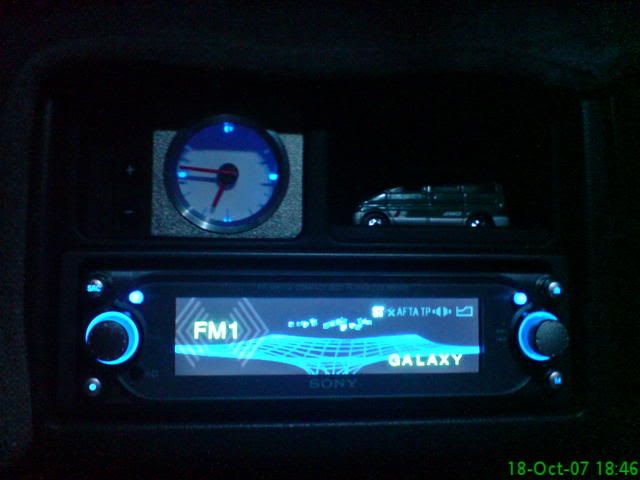

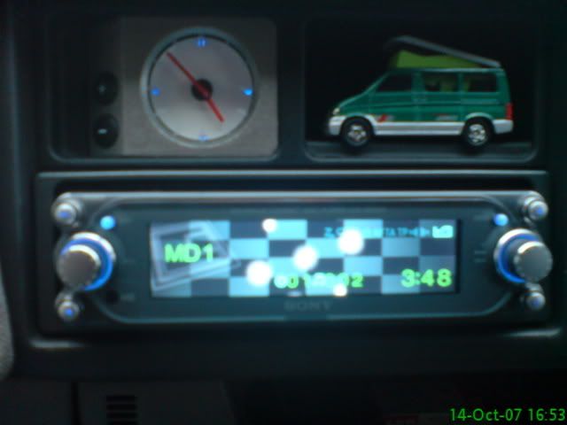

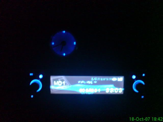

Post by bigdaddycain » Thu Oct 18, 2007 7:28 pm
Haydn very kindly sorted me this really smart white dialled bmw clock to compliment my white dials... and the alloy surround too (which is a perfect fit :wink: )
Here it is in varying degrees of light....
The alloy surround hadn't been fitted when the first pic was taken.
Thanks for the clock Haydn...it's spot on :wink:

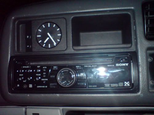

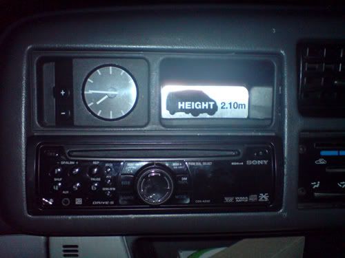

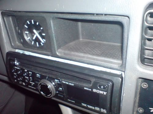

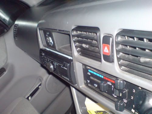

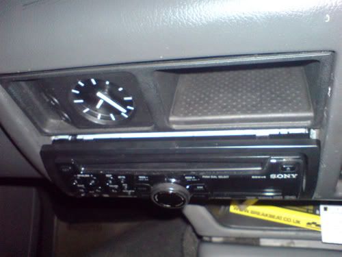

Post by meek.tv » Mon Oct 29, 2007 9:45 pm
finally got mine in (well the fairies fitted it while i was in work today.......ok my dad did it for me)
problem is it looks great from the front.....
.........but the fit is slightly out so when you look at it from above the clock seems too far back or the cd player is too far forward (not sure which)
is there a trick to getting it to sit nice? dont want to force it as my dad broke his doing just that :(
and heres a pic of it with one of my AMAZING height reminder plates ;) fits nice
