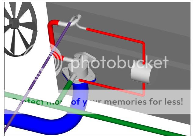

Changed tactics on the drawing after comments from members. Back to the drawing board :wink:
Now being produced in 3D like Grahames but viewable from any angle.
To get the detail spot on, I need to know precise detail of component parts, and in particular, the thermostat area.
If anyone has stripped their system apart at any time and has photographs of any bits, please send pm with email address.
Soooooooooooo close to a result here :D

Taster of what I've been doing.
I abandoned the original 2D sketch and reproduced the complete system with a 3D version.
I used the original grahameatwork drawing (with his blessing) as a basis, just added a few of the finer connection details.
The test of wether it has been of any value in making the whole thing easier to understand is open for comment.
The above is a very small part of one of (what I think) the more interesting areas of the system with lots of text information omitted.
Is it clear to you what it is?
Thanks to Kirsty and Hatdn for pointing out errors =D> .Image
Now corrected.

Post by mister munkey » Sat Nov 14, 2009 4:20 pm
Even to my simple semi-evolved simian brain that looks brilliant. Simple, clear & concise.
=D> =D> =D>

Certainly getting there, looks good to me, easy to see what it relates to on the bongo :D Where the hose goes into the stat from the front heater, it should be a T-piece where you've got an elbow, the other arm of the T being the return from the rear heater.

mister munkey wrote:Even to my simple semi-evolved simian brain that looks brilliant. Simple, clear & concise.
=D> =D> =D>
Thank you - makes me happy to know its not all been in vain.
Don't know if I have connected all the pipes 100% correctly - am waiting for replies from others on that score.
The amount of informatiom I propose for the FINAL thing will be far more than you can currently see. Faaaaaaaaaar more.

OK OK so I've been persuaded (Kirsty can be very persuasive :? ) to overcome my dread of coolant system related debates and start reading this thread :oops: :lol: :lol: :lol:
That diagram looks superb - when done it should prove a real asset to the Bongo Library. I wonder if there is any way (bearing in mind it is so obviously a work of love and the result of a lot of hard work) that Mazda could be persuaded to look it over and sign it off as being a correct representation of how the Bongo's circulation works. I mean, wouldn't THAT be cool(ant system :lol: ). I wonder if Ron Miel - hint hint Ron - would find it an amusing diversion to try a line of enquiry with them while his knees are mending. He certainly has the right skills and interest for that kind of thing. :roll:

Looks great Widdowson. As all but one of the hoses are on the return side shouldn't they be coloured blue (lighter shade maybe). The top hose from the turbo has been subjected to heat so should be red IMHO.

The Great Pretender wrote:Looks great Widdowson. As all but one of the hoses are on the return side shouldn't they be coloured blue (lighter shade maybe). The top hose from the turbo has been subjected to heat so should be red IMHO.
!00% with you on that one.
Ignore the colours for the time being. I needed to make them like that initially (vividly different) until I have got the circuit absolutely correct.
Once thats been achieved, then I will need to find out precisely which direction coolant is flowing in every single single piece of pipe. I have a good idea but I want to be absolutely sure before comitting.
Then, the pipework can be colour graded - red/blue gradientificationified :wink: (I think I can do this anyway) to give an indication of direction of coolant flow. Shall seek advice on colouring later.
Remember, I am a thickie at this - basically applying what other folk are telling me. If any information I get conflicts, then I check, and check again until it makes sense to me. Then I commit to the drawing.
I'm helping myself to understand the system here, and if that helps others along the way, then fine.
I must be convinced that what I have done is correct before 'going public' so to speak.
One very important area under scrutinisation at the moment is the thermostat. Dandy is also trying to find out. Get this bit wrong and the whole bag o' mashings can go in the bin.
Has anyone split one with an angle grinder and had a look inside?
It is my belief, from what I know so far, that the inside of the thermostat is not simply a straight through jobbie. I think there may be some nifty porting going on in there.
Anyone know?
