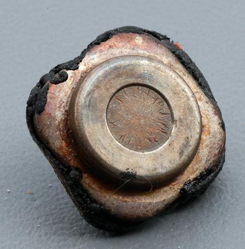

Roof bar mounting stud
smartmonkey
Post by smartmonkey » Tue Apr 17, 2007 11:53 am
Sikaflex-221 is the correct product. Araldite and silicone are not reliable (silicone for goodness sake). It is a gap filling flexible adhesive that is used in the assembly line to glue wings and captives on. You can get it from the paint suppliers - most accessory shops won't stock it.
vanvliet
Posts: 2081
Joined: Tue Aug 09, 2005 6:33 pm
Location: Fife , Scotland
Post by vanvliet » Tue Apr 17, 2007 12:25 pm
Fair comment about silicon.Why do you comment that Araldite would not be reliable for this application ? Have to say that I have never had a problem with it ,if everything is prepared properly . Seems a lot of money to buy a tube of Sikaflex( about a tenner from boating chandlers -you need a gun to apply it -same as tubes of silicon) for four captive nuts.
The the black stuff on the captive nut couldnt have been too great either as it came out!
BTW - I think that these nuts were actually fitted in the roof to attach a roof lifting cradle, not a roofrack

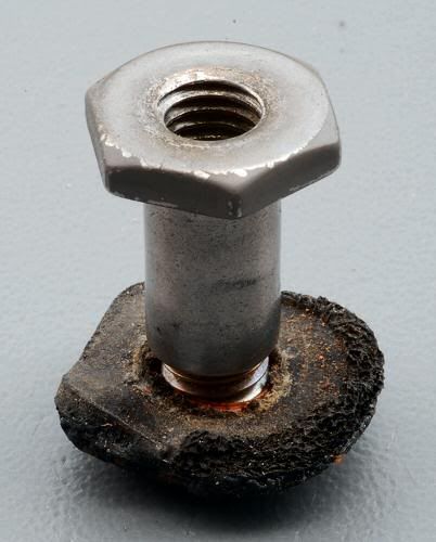

Roof bar mounting stud - update
Post by bongolow » Fri Apr 20, 2007 4:41 pm
I bought some Sikaflex on ebay but before I used it I checked the other studs and realised, after I'd cleaned the crud out, that there were bolts in the others coming up from below. I had a look round and found a square headed bolt lurking behind the AFT runner.
So the studs are actually held in by these - I must have unscrewed it when I removed the roof bar. It is possible to manipulate it back into position without removing any of the roof lifting mechanism, so I used a dollop of Evostick on the stud to seal it and a drop of Locktite on the thread.
The other rear stud was loose so I did the same on this. The front two seemed tight so I left them alone.
Some pics...

Yep As it is part of a lifting mechanism it makes more sense
