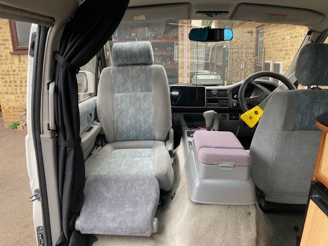

Highly recommend the New Dawn seat.
If you can't get it fitted, they operate a mail-order service, send in your seat base and they mod it and return it to you.
It's very simple to remove the seat and refit after the mod.
I added this mod to my van and it's probably the best change I've made.
