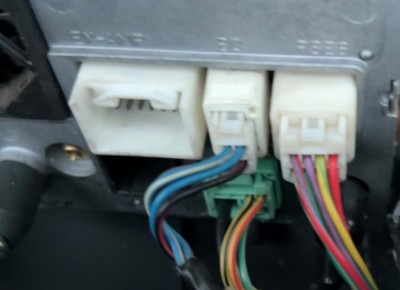

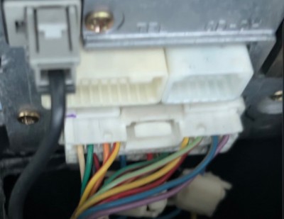

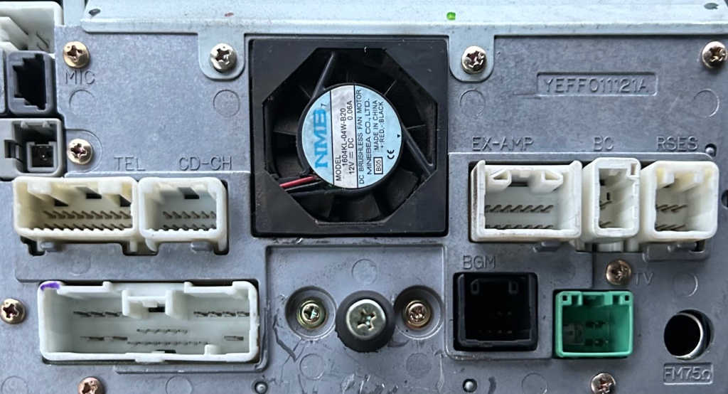

I've removed my Japanese double din stereo/cd mini disc player (eventually!) and am looking to fit a modern touch screen unit. However, I have quite a lot of plugs to find adaptors for. I believe I need a PC2-78-4 adaptor for the big plug, but what about the others? - ie., the 'BC' and 'RSES' ones? I have a reversing camera fitted, but I'm not sure which one that is (the green one?).

I think you will need to look in the Manual to find out what the other connectors are for, the Bongo won't have the wiring for them existing they will need to be fitted to connect to the other external devices. You don't say what make or model the device is so I would suggest a google search for "Make Model Manual" to find out what they are.

Thank you for that. I haven't yet found a manual for the unit, but I have found out today that BC might be the link to the vehicle's computer for trip, mpg, etc (Board Computer?) and SRES is to do with the mobile (or sat nav?) network ("SRES stands for Signed Response, which is a crucial component of the GSM (Global System for Mobile Communication) authentication process"). So if I'm going to be connecting up to an android unit then I won't need those plugs connecting.
I'm figuring that most modern units have the ISO connections, so the correct adaptor for my 20-pin Mazda plug should suit most units.
I haven't yet decided on any particular model, was hoping for some recommendations from fellow Bongonauts 🤞and if I get a unit that takes a reversing camera then hopefully I'll be able to connect my current camera without too much trouble.
