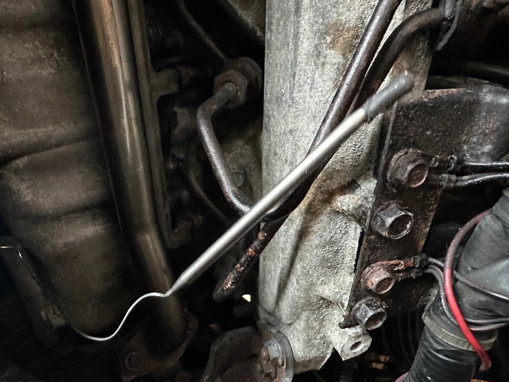

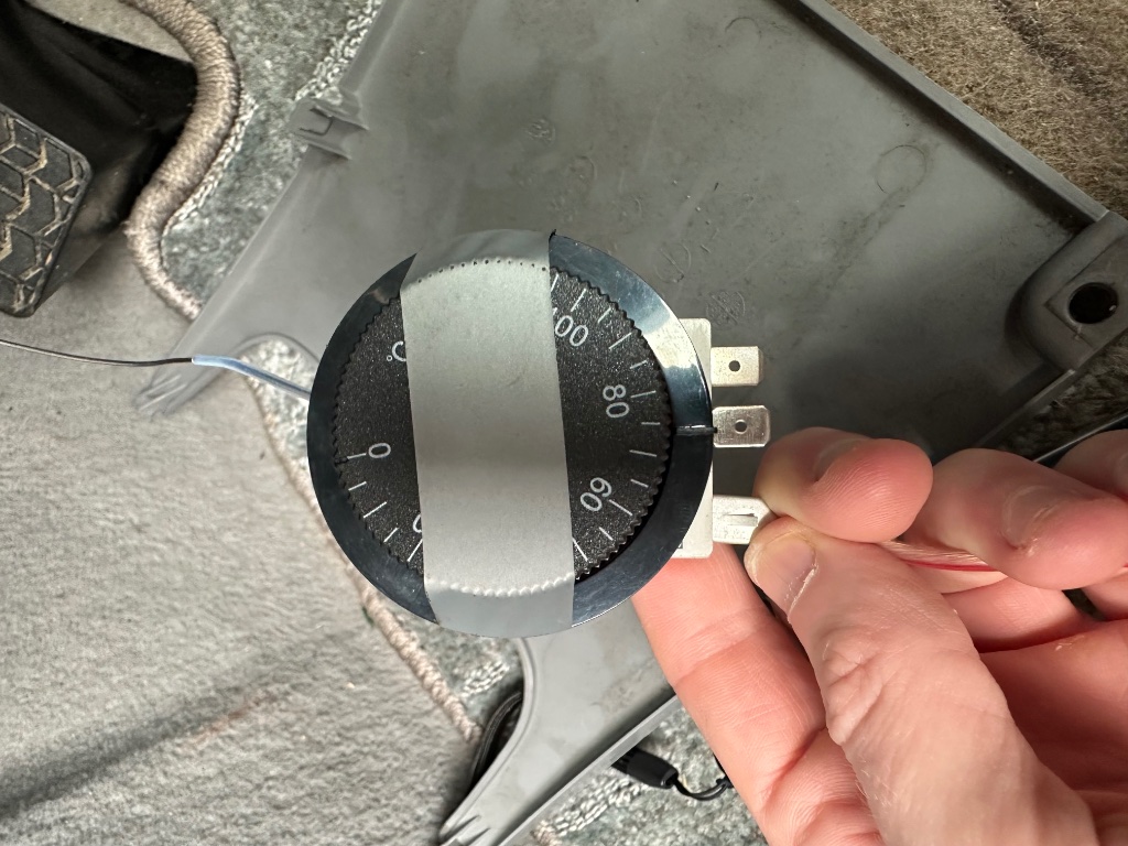

Under the steering column there is a 'component' that has a dial/adjustable switch, and it dropped down while driving yesterday. It is not fully 'connected' to the fuses etc. and doesn't seem to have any negative effect on the van. Following the cable out of the 'component' and the other end it goes to a metal rod under the driver seat but again this isn't connected to anything.

Just an after market add on looks to be measuring the temperature of the pipe in the third picture and then the dial in the first picture controls when the thermostat switches the electrical contacts over, you would need to follow the wires back from the socket its plugged into, unless its already been left unplugged and just left dangling under the dashboard - not uncommon to find loads of wiring from old Japanese wiring of addons that have been disconnected and then just left doing nothing!

Yes it looks like one of these.
https://www.ebay.co.uk/itm/200929164720 ... psQAvD_BwE
normally used to control a fan but could have been used for anything really. I remember them in use for the aftermarket electric fan conversions when cars still have them running from the engine.
I also agree it looks like its no longer in use.
