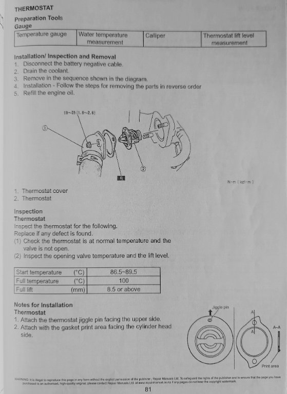

Afternoon, does anyone know the torque setting for the 2 x nuts that hold the thermostat flange on to the engine? Thanks
Posts: 10941
Re: Thermostat Housing flange 2.0 Torque setting
Post by g8dhe » Thu Jul 13, 2023 4:58 pm
looks like 19-25N-m or 1.9-2.6kgf-m

Post by kton2002 » Thu Jul 13, 2023 5:13 pm
Thanks Geoff that is very helpful.
Wondering if i need to drain the entire system to do this, it says on that page to drain it but as its near the top i would assume i can just catch whatever comes out as best i can and then refill the expansion tank.
Posts: 10941
Post by g8dhe » Thu Jul 13, 2023 5:52 pm
Well the 2l is self bleeding so its not so bad to refill it and clear the engine of air, so maybe drain it and save the coolant to later refill maybe ?
