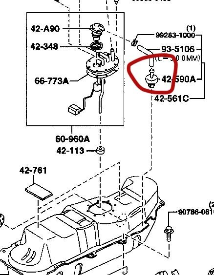

I checked banjo filter and it was clean. also pipes to the tank aren't corroded, also, Im curious if this is what you meant by the breather/ one way valve?Northern Bongolow wrote: ↑Mon Jun 05, 2023 7:19 pm
The tank itself also has a breather and one-way valve on it ,this is clipped on to the side of the tank itself viewed from under the van. The breather is about the size of a small cotton reel and just pulls off the tank then off the pipe end.

That's one of the 2 valves which are at the end of that pipe. It's clipped on to the chassis, just pull it. Then remove it from the end of the pipe. Just inside the pipe end is a little thimble one way valve too. Clean em both out.
Re: 97 Diesel Hard start and stalling when less than half tank.
I removed and cleaned the valve inside the hose on the breather. It wasn't dirty and didn't seem to make a difference, I also ran the van with out that part on and it didn't make a difference.
