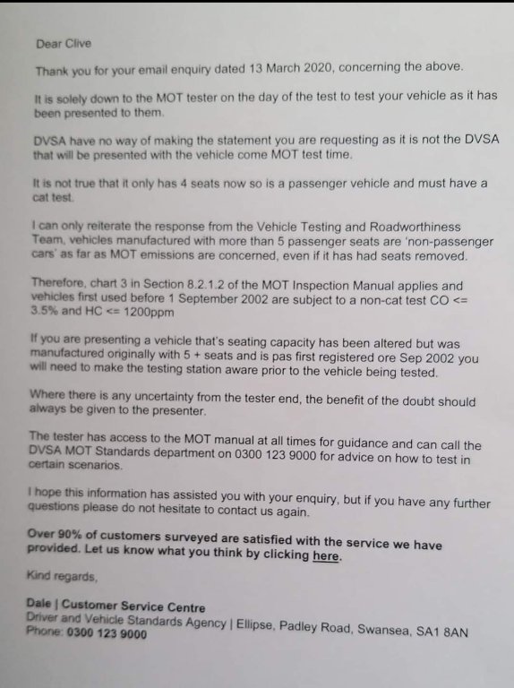

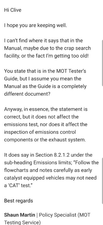

As you have a pre September 2002 you don't need a cat so can just put a piece of pipe in to replace the stolen cat, as the Bongo should have a non cat test at mot time 🚐

Post by Ian » Tue Oct 19, 2021 9:06 am
However, this i also from the MOT testers guide:
"If a cat was fitted at the time of manufacture then it must be fitted at the time of inspection."
That doesn't mean it has to be tested, just present.

Post by Winnie-bongo » Wed Oct 20, 2021 3:33 pm
Ian wrote: Tue Oct 19, 2021 9:06 am However, this i also from the MOT testers guide:
I just asked DVSA this very question Ian
