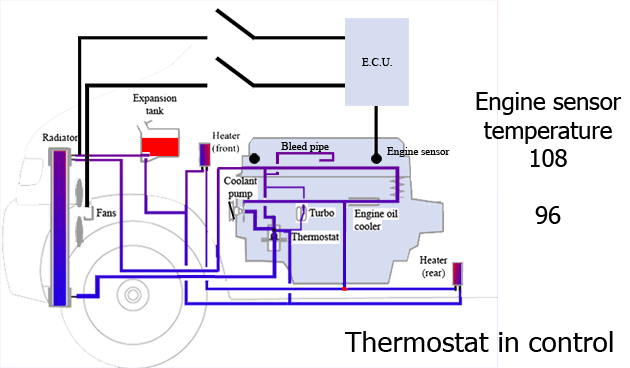

Posts: 10791
Re: Overheat query
Post by g8dhe » Sun Nov 08, 2020 11:04 am
They don't come in till quite late in the day here is an animated GIF of the process;
DaveH76
Posts: 23
Joined: Mon Jun 15, 2020 12:23 pm
Re: Overheat query
Post by DaveH76 » Sun Nov 08, 2020 2:26 pm
I’ve seen that GIF before which is really good! If it had the scavenger fan operation on it to then it would be even better (easy for me to say :lol: ) =D>
