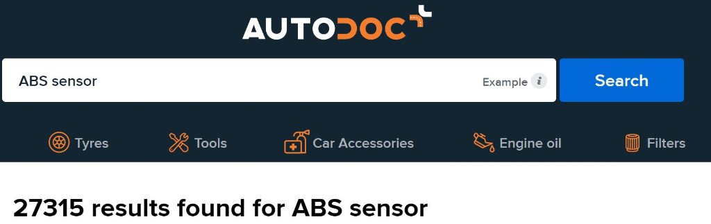

i bought it from autodoc they were £5.80 on ebay and £2.75 from autodoc only downside was they charge £7 for delivery so in hindsight ebay is cheaper ive got some photos of part no on box but they are widely available stupidly enough the connector plugs are about £6 each but sure beats paying almost £200 for a "Bongo" abs sensor for the sake of a little soldering

Humm not that many to choose from then;
