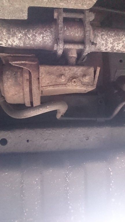

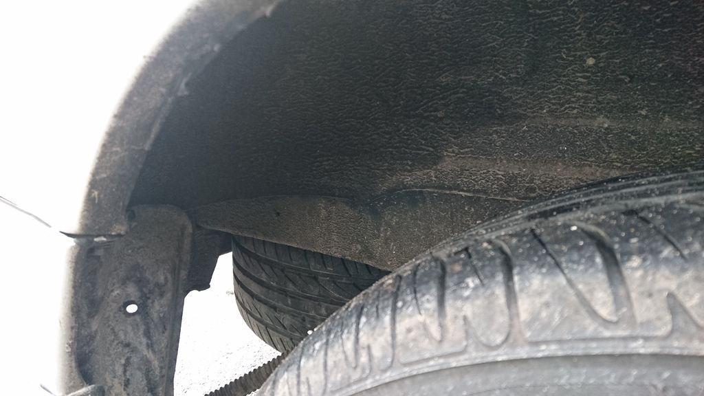

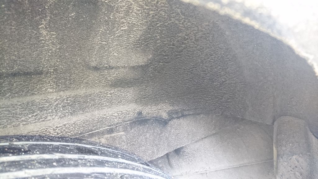

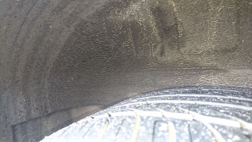

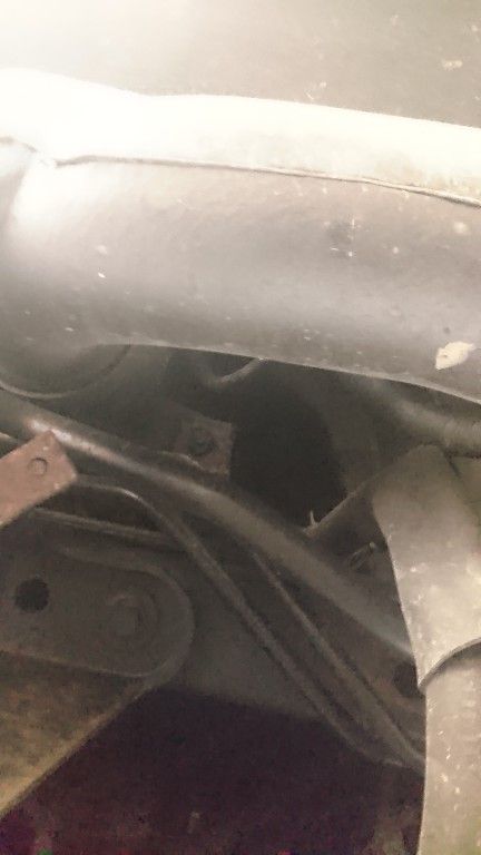

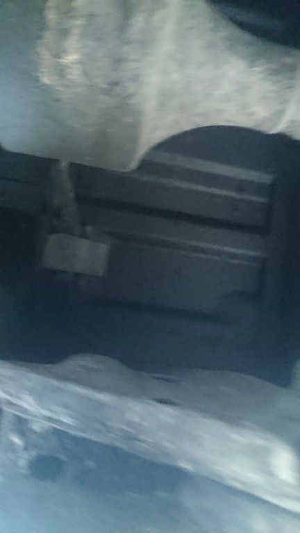

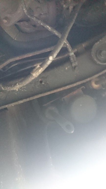

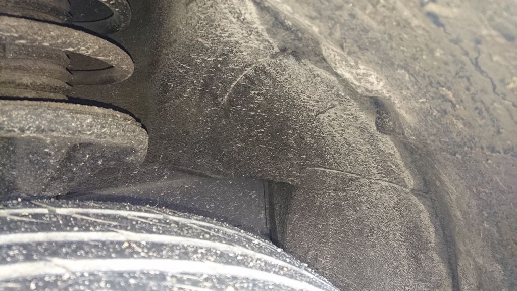

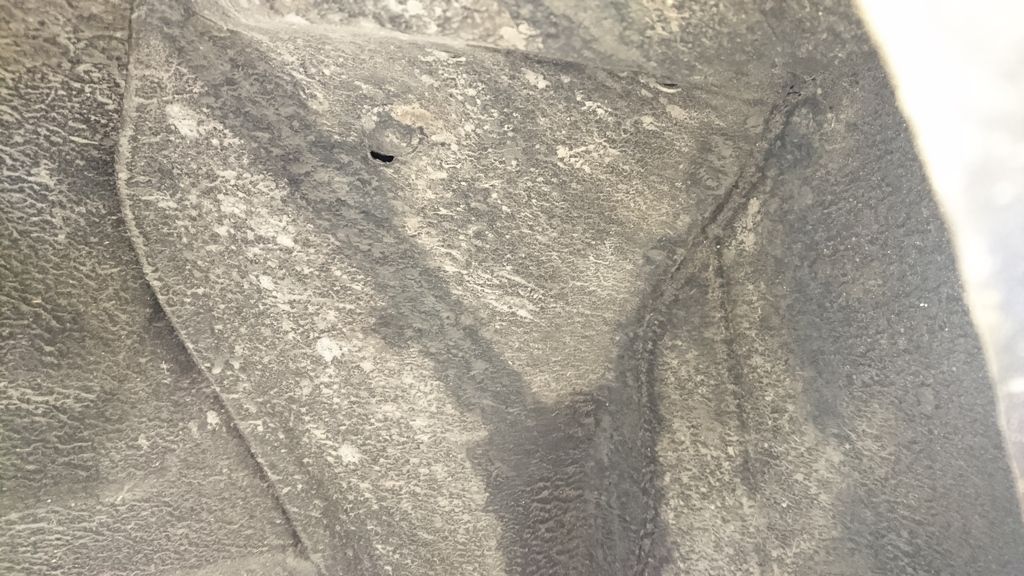

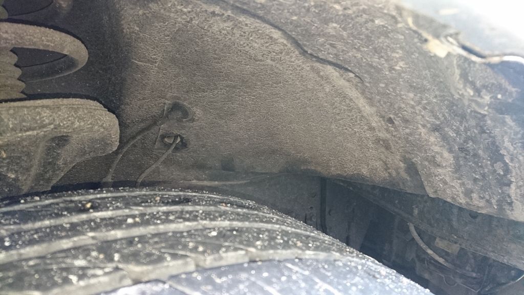

Apparently these pictures were unwashed and after a trip to the beach which should explain the sand.
Apologies for the picture dumps btw. And really appreciate any advice here as I really don't know what I'm looking for.
This is a 2000 2.5 td 4wd with 80k miles with full side conversion. Looking for 8k.
The radiator was replaced last year as there was some corrosion. So perhaps this is a major red flag already?
Looks well otherwise.
Finally, assuming there are no major red flags with the above, can anyone recommend a reliable bongo mechanic in the Barnstaple area? I wanted to have it looked at if I was considering it seriously but Allans in Plymouth is a bit too far apparently.
Thanks for any input folks!

The photos look OK, bearing in mind it is 17 years old. And I wouldn't worry about a changed radiator too much. But try to find out who performed the work.
There is a Bongo friendly garage in Barnstaple called A&R Auto Repairs see http://www.aandr-autorepairs.co.uk/

Agree with Ian forasmuch as i can tell what i'm looking at. I'd have liked to see area underneath around rear heater unit (if its not been removed) and metal pipes connecting to it and also where rear arch joins cills and where crossmember joins cills behind front arches (where my first rust hole happened at Bongo only 13yrs old). But look ok. Barnstaple and beaches = salty sea air and sand. Is paintwork in good condition (no matting or pinhole rust spots), and i'd want to pressure wash then refresh waxoyl on underside.
Radiators are generally replaced because they're leaking or blocked. Radiator cross member supports get cut out and new ones welded in due to corrosion. This is a common repair in ageing Bongos but it does flag up what stage in corrosion might be present generally (it was near the first, but not the first, bit of rust repair needed on my 22 yr old Bongo, when it was about 19 years old, and even though it had been professionally waxoyled/dinitroled at 11yrs old). I think its best to expect budgeting for some welding within the next few years. The key thing is to be vigilant (i.e. don't wait for MOT failure to tell you) and source a good outfit to prod with a screwdriver and repair/weld sooner rather than later. I take mine to a great guy (Adrian at Japandirect in Bury - shameless plug!), when MOT is due and we put it up on the hydraulic lift and look everywhere underneath for stuff needing attention even if its not an MOT fail. And i keep an eye out also ehen i'm washing it etc.
Where are you travelling from to view it?

Here are some of the areas to watch out for.
https://goo.gl/photos/Rrmcq1oCC3yNLkpE9
The floor pan image applies to both foot wells you will need to lift the mats.
Other ones are front cross member (not shown) you will have to get in between the lower plastic scoop cover and the cross member to feel for that, rear cross member above exhaust behind heat shield, underside where the rear heater unit fits (the image with the two heater pipes exiting),behind the rear bumper corners both sides and inner sills. The image of the pipe work is on the offside underneath these tend to corrode around the support brackets and the tee joints.
Take a good torch, a pen torch, something to prod with, a magnet(from an old speaker is good) and a mirror push any suspect areas gently and check for deflection or "softness" run the magnet (wrapped in cloth) just off the panel surface over any areas you suspect of being filled like the rear arches and measure the pull on the magnet. chances are there will be filler somewhere on the van but it will give an indication of previous work but obviously not the quality.
If you can get any images of areas you have doubts about then post them up and we can take a look at them.
