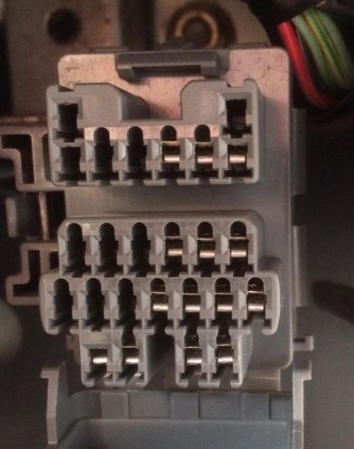

secondly, trying to read the code, what a mare I have a 2000 facelift and the plug is different from the documents available, anyone know what pins I should short? see pic of the socket below.
Plus, should the enginer be running or not when I read the code?

The socket is the same - just that its mounted upside down, as they all are ;-)

But when I short the ones in the document I do not get any change in the flashing sequence? Should the engine be on? tried on and off?
Any help to get a code would be appreciated

The connector should be setup like this the Black wire shorting, and the Red wires via the bulb or LED (if you use an LED make sure you have it the right way around, if it doesn't light at all reverse the Red connections);
This is for the Engine Diagnostics Glow Plug flashes, not the transmission when the Hold light flashes.

g8dhe wrote: This is for the Engine Diagnostics Glow Plug flashes, not the transmission when the Hold light flashes.
Just to say, when I put the shorts in on the diag connector (Can't remember which ones off the top of my head), my 2001 diesel glowplug light then flashes out the sequence, not a lamp/LED on the connector. I think it's in a fact sheet somewhere.

Yup it does on the later models, but not the earlier ones so to play safe I have shown the bulb ;-)

Thnaks G8 worked a charm and I got a code ... now the next weird bit, anyone seen this?
