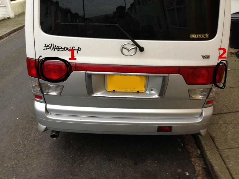

Hi all,
Okay, so it appears that my brake bulbs have (possibly) blown.
But first, I have a very basic question to ask:
Where is the brake bulb found in the rear light cluster? Is it in the part marked 1 or 2 in the pic below?
Thanks!
Paul

Bulb 1 is sidelight and bulb 2 is side + brake. With the high level brake light (if fitted), you should have 3 things illuminating when the brake pedal is pressed. If they're all out, then it does point to the brake switch above the pedal. Remove the 2 connectors and short them together and that should light them up.

That's interesting about the brake light switch. I'm pretty sure that one brake light failed, followed by the other a few weeks later. To me that sounds like it's the bulbs, no?
If the switch has gone, would the spoiler brake light stop working too? It still works at the mo.
I have removed the side cluster (marked 2 on my pic) and all of the bulbs appear to be working. Again, forgive my lack of mechanical/electrical understanding, but Simon - are you saying that there is only one bulb in the side+brake section that covers both braking and general illumination when the lights are on? i.e. It (should) simply gets brighter when the brake pedal is depressed? There are only three bulbs in section 2, including the indicator and the reverse lights.

Ok, the brake switch is working, so you're just looking at a duff bulb. I don't recall the exact bulb fitted, but I believe it is a twin filament with one for side and one for brake.

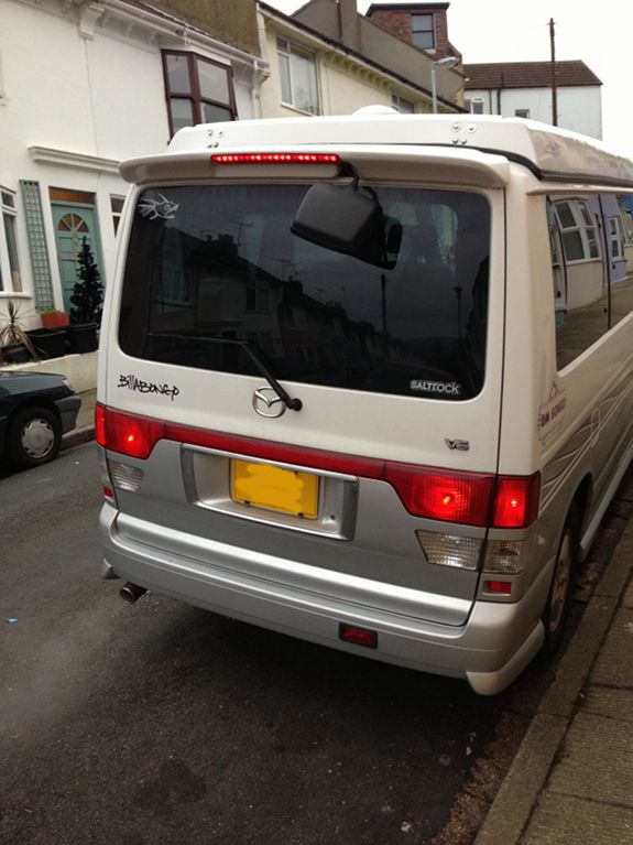

This is what's confusing me though. This is a photo with lights on and brake depressed:

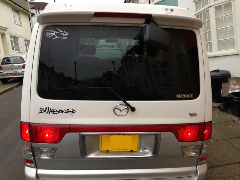

This is with lights on and brake off:
When the lights are off and the brake depressed, only the spoiler light comes on.
Does this mean that the brake bulb is working, but somehow not coming on when the brake pedal is depressed?
Apologies for making a meal of what is prob a very simple problem, but I can't quite understand what's happening here.

Apologies - just read your reply again, and I think I understand.
I assume it must be possible for one filament to blow in a twin filament bulb, and that in both cases the "brake" filament has gone?

Yes, the 21w brake filament looks to have blown while the 5w side light is still working.
