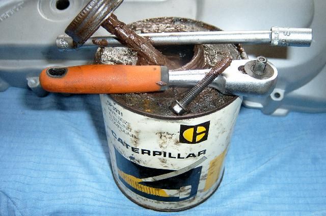

Mine are steel wheels and they where rusted onto the spigot / hubs ..
I sprayed some penetrating oil down the bolt holes and managed to a get few clouts on the edge off the wheels with a heavy rawhide mallet and that broke them away from the hubs ..
Before refitting them I brushed some anti seize grease around the face of the wheels and hubs ..

Wow, that was some spray of penetrating oil!!
