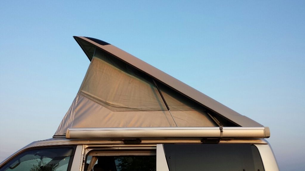

Post by bongolou » Wed Aug 28, 2013 10:48 am
I will take a close look and maybe post a picture for you to see, i think you maybe right but im not 100% sure either. Here is one of the awning itself with the roof up but i will take a close up view later to look for the channel for the kador to attach into. Would i buy kador in the exact length as the ykk awning or longer?Image
