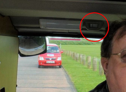

I have a factory system fitted ....4 x sensors in the rear bumper and 1 x sensor on the front passenger corner....a screen on the dash and a repeater screen in the rear roof you can see in the rear view mirror when reverse is selected.

I think you'll find the Mazda fitted Corner Sensor system is as Haydn describes with two displays one on the Dashboard and the other visible in the Rear mirror, see below;
Image Image
and the wiring looms are as in the diagram below;

Personally, I would get a new kit and replace the lot. I've bought several sets of eBay for about £15 - £20 and always found them to be very reliable and easy to fit. Typically, you get 4 sensors (and a hole saw for the cut out) and a display with coloured LEDs to indicate distance and a readout to show the actual distance. There is an optional beeper which can be used with or without the display. Very simple to fit: drill 4 holes, push sensors thru and run the wires in thru the grommet behind the rear light clusters. Control box is wired in to the back of the reversing light and sits behind one of the rear side panels. Either run the display to the front of the van, or mount it inside the opening for the tailgate like the one Geoff has shown. The other good thing about these kits is that they usually can be ordered with a range of different colour sensors, so you could get silver, black, of whatever colour bumper you have.
