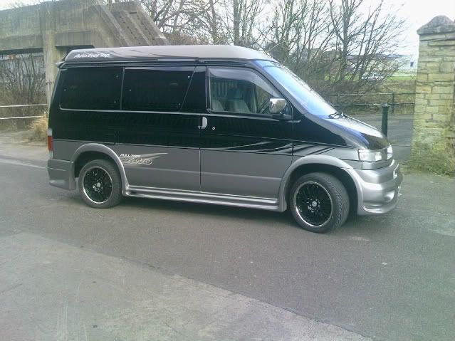

Mind you, TBH I have found my MPG to have dropped by a massive 1 MPG since the swap, diameter is exactly the same as before so it could be increase in weight or as they are wider more wind/rolling resistance than before.

I should of gone for 19" or 20" looking back now but
