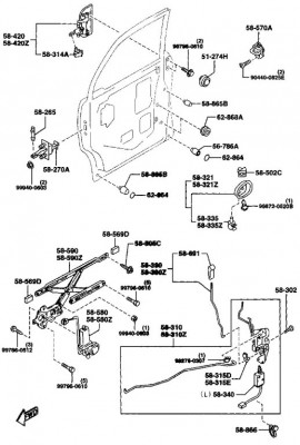

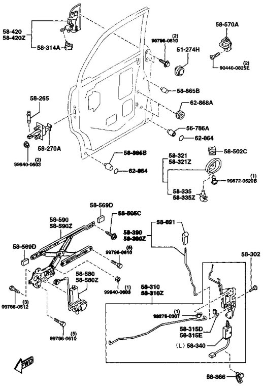

Can anyone tell me how to remove and replace door latch, I cant seem to be able to shut door, maybe its twisted or jammed.
I have removed inner trim but cant get passed the steel panel for all the workings i.e. window mechanism, lock handle.
Hope someone can help, many thanks in advance

Do you mean the sliding door or passenger door ?
Have you tried the mechanical parts drawing site for more info ? http://www.lushprojects.com/bongopartsmk2/

Hi Ian sent me plans (thank you Ian) but cant get to them unless inner STEEL panels can be removed

Posts: 10964
Re: Passenger side door latch
Post by g8dhe » Mon Jan 11, 2021 2:48 pm
Which bit are you trying to gain access to ?
The loop - striker on the "B" pillar 58-570A ?
The motor / lock within the door 58-340 ?

Post by turfite9999 » Fri Jan 15, 2021 11:48 am
Hi Geoff thanks for your question, it1s the latch 58-302 I think which locks onto 58-570
regards
Tony
Posts: 10964
Post by g8dhe » Fri Jan 15, 2021 12:23 pm
58-302 is the screw that holds the locking mechanism in place, if you unscrew that then the motor and lock itself will come out of the door once you have released the wire links to the handle and locking button full details of the mechanism here http://www.lushprojects.com/bongopartsm ... no=.html#5 which holds all the mechanical/parts diagrams .
