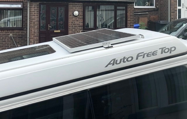

Does the tin top have roof bar mounting points like the AFT? I just made some brackets and attached - did this the same way on previous one too - I’m not keen on the stick down with glue approach. Thought about single 200w panel as it would just fit but despite best efforts couldn’t really find anywhere suitable for 2nd leisure battery - would just fit where rear heater was and vent through holes but accessibly difficult after side conversion.
