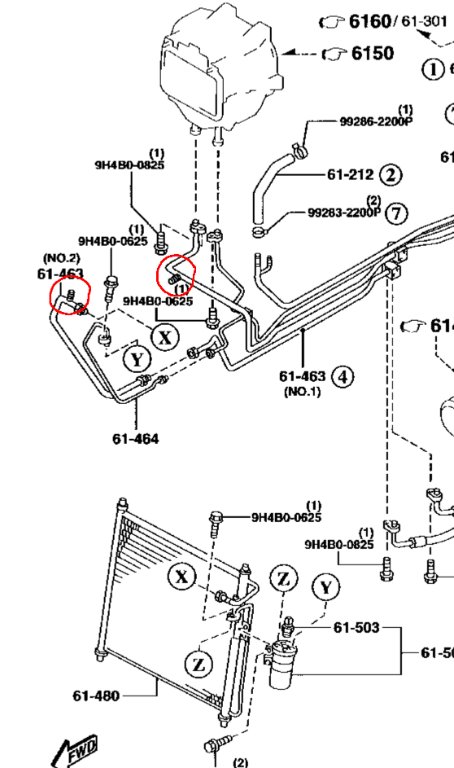

Re: Air con valve locations
There are two outlined below the High pressure one is top right front of the radiators, and the Low pressure one is bottom left behind the radiators, both have, or should have, a plastic cap marked H or L, think you need to remove the air scoop for the Low pressure.
Thanks both - was easy to locate both, not dificult to find once undone two clips on the air intake scoop. Of course when they pressure tested it it dropped a couple of bar pretty quickly. Money refunded though so can't complain, took them an hour of tests so not really a money maker. Heads up, ATS Euromaster in Winchester were great, accomadating and corteous.
