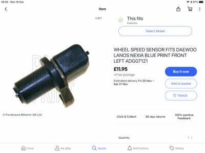

I’m glad it works I’m not afraid to go outside now my sensor is a perfect fit maybe because my hubs were shot blasted and the clamp slides out enough to line up with the fixing hole. What connector did you use
Re: abs sensor
I used the same connector as you did with the inserted piece of plastic to spread the connections
https://www.ebay.co.uk/ipp/263063123791 ... 675.l48352 .
The metal bracket of the sensor did slide out for me too but there was only a 6mm hole in it, I popped it off to see why the bolt would not tighten and realised I had to drill the larger hole.

Hi all, just wondering if there were any other sources for this wheel sensor? I note they are out of stock now on the previous link shown (probably all of us buying them for our Bongos!) and I don't seem to be able to find the same one on eBay.
Does anyone have the link to the one in eBay?
Or any suggestions from anywhere else?

Looks like blueprint do a version
