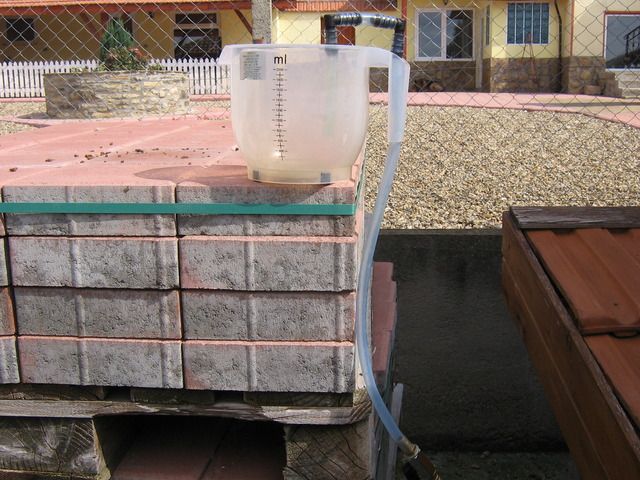

When bleeding the Bongo, the big bug-bear is often the funnel full of hot coolant ....VERY hot coolant , if you've done it right. Tony always managed near burn status on his hands, and it made the job hell, with me sitting doing the throttle and topping up, and Tony doing a jig with burning hands. The other thing has always been could we trust a garage to do it with the funnel. Frankly, if I was a mechanic in a workshop, I would likely think it's a bit Heath Robinson, and unlike any other car...so....like others, I scratched my head for something simple.
We stopped using a funnel some years ago, and used a jug full of coolant and the bleed hose in the jug giving off bubbles. It's worked for 15-20 times (we have done a lot of experimenting with the cooling system / gauges). Still the same problem with putting the jug down with one hand and wrestling with hot coolant and a bung to put in the hose. Still the burning hand issue! We looked at valves, semi-automatic with taps and floats, you name it, but still the issue of "would a garage play"
Eventually , the obvious hit....so simple, it's ridiculous! Here's the photos:
The jug is a polythene jug with a hollow handle, and this is cut to feed the tube through. The tube is 10 mm PVC or similar, and the joints in the tube are standard hard right-angles. The tap shown is a 10 mm fuel tap. This probably needs to be metal to work well with one hand.
The first photo shows the tubing cut to fit into the handle, but swung out of the way, and cut to fit the angled pieces, so that when it's turned to fit into the jug, it is below the fluid which you put into the jug to cover the end of the PVC tube.
The tap fits into the Bongo bleed hose, and you can clamp it in. Bleeding follows the funnel procedure, raising and lowering, as per the videos, but should there be an issue, like running low on fluid, then just turn the tap off, leave the engine running, pop round and top up.....your LCA will warn you if you get low on fluid! Also, when the process of bleeding is finished, you can can turn the tap off, and keep the tap at a height a bit higher than the engine, wait 'till the coolant is a bit less hot, and whip the tap out and put the bung in the end....no burned hands, and no clumsy gloves!
The other issue, is that you can have the tubing cut to size and ready fitted with the angle pipes, all ready to go. all you do is pop it in the handle, and fit the tap. It can all fit in a plastic bag and live in the Bongo, plus the jug can be used for topping up oil. Mainly, when it comes to a garage using the kit, it's something that most mechanics will use...namely a jug!...not fiddling with a funnel, and it must seem more logical and practical...PLUS no likelihood of burning hands

Yes..that's the beauty, it does work the same...emptying and filling the jug when you raise and lower or rev it just as in the funnel. It is also capable of holding 2 litres.
We did that for 15 or so bleeds using a jug with the bleed hose from the engine straightened out at the loop end, and clipped to a stick with cable ties...but we always had a washing up bowl on the floor in case it got too full, or there were a lot of mini-bubbles in that I didn't want going back into the engine, then Tony tipped the excess into the bowl, and I topped up.
My first thought was "would the downward curve of the PVC tube into the jug act as a bubble trap?"...but when the bubbles accelerate from the engine as you raise it higher than the head, they will shoot over the loop and down, in fact with the PVC tube, you can watch the air pass.
Bubbles in tubing used to annoy the crap out of me when I worked in labs, but my colleagues used to ignore them, because they never interrupted the MEASURED flow of liquid, but for me they never looked nice....(GGGGGRRRRR), and I had to get rid of them, and juggling the tubes like in the Bongo bleeding process, I always managed to shift the bubble!...so...yes, juggling up and down accelerates the liquid, and inertia just pops the bubble through, and as I say, you can watch the bubble in the PVC bob back and forth until it pops out and you get solid flow of fluid.
Mike...
Yes...it does work like hooking the bleed hose over the steering wheel, and you get the added advantage of the tap to shut the flow , so you can pop round and top up, and go back to where you were until the flow is clear and solid.
The big thing for us is that it's a "no burny hands" job, as both Tony and I are ex- Navy...different areas / uniforms, though, so when the coolant hits 91/ 92 on the temp gauge, and the fans kick in, words are exchanged that aren't in public use , as the coolant hits even industrial gloves , also you can't use thick gloves to put the bung in the bleed hose (I've tried...(ouch))
Teenmal...It's the simplest I've tried, and it doesn't burn...and is less bother ....but everyone likes what they like :D
I also like to leave the kit handy in the Bongo in case it needs doing at a garage, so it's easy to fit together and show the mechanic, and the jug's handy for filling oil. Maybe it's me , but showing a garage how to juggle fluid in a funnel makes me feel uneasy and I expect the sort of "who's the nut-case?" look...I know many garages have no issues with it, but I think it's an easier "sell" to show something that every garage has (like a jug), than a funnel...but , hey, that's only my take?
