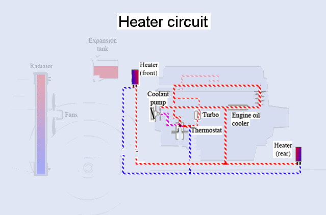

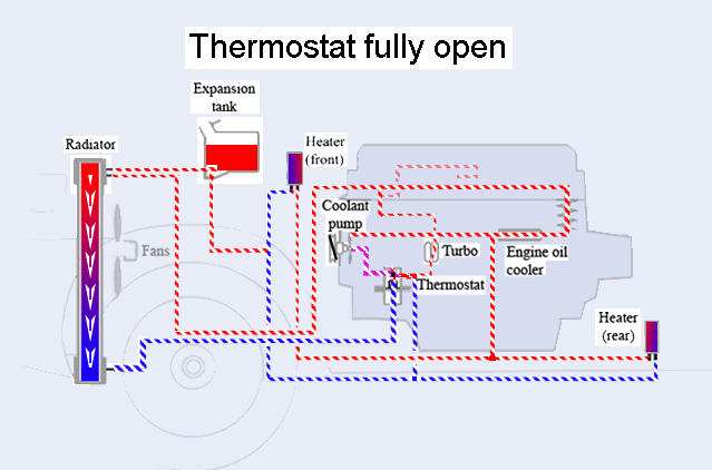

At TGP's request, altered the colour of the flow between the stat and the pump to purple to attempt to show a mixture of HOT and COLD coolant. Also added the flow through the radiator. Hope this works for folk.
Heater circuit
Thermostat closed
Thermostat open
Heater circuit
Thermostat closed
Thermostat open
Steve
