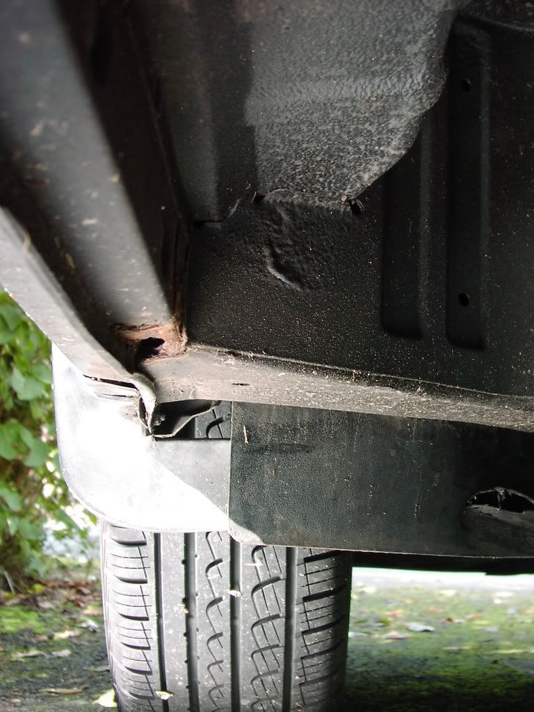

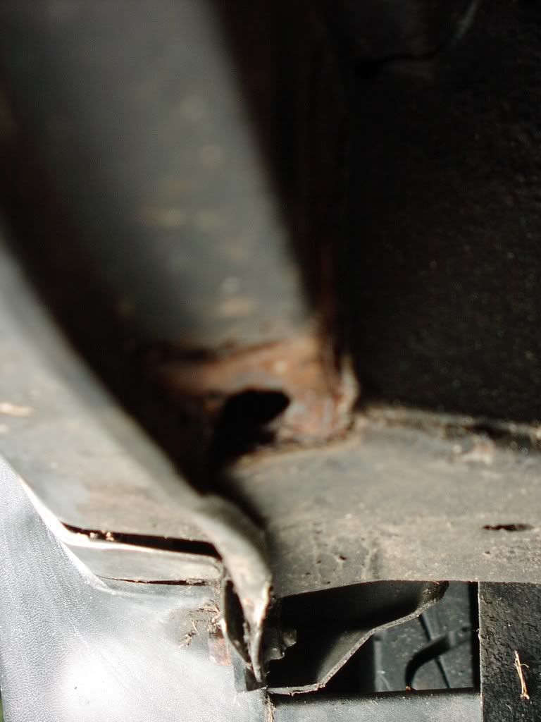

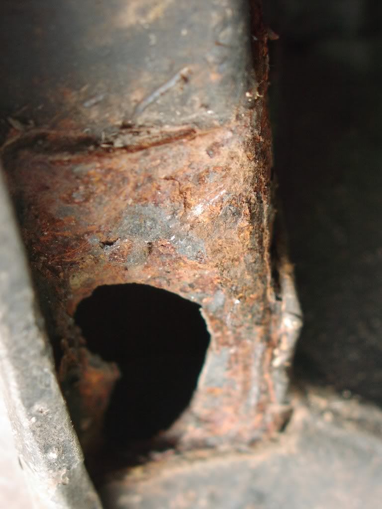

Spent some time underneath the Bongo on Sunday, giving it the once over. Very peaceful under there - no kids arguing, away from the mess in the house etc. etc.
But despite Mango having a quality underseal job done 2yrs ago, I came across a bit of localised, but severe rust (would have been well established before the underseal job and I suspect worked from the inside so not much could have been done). But what has caused it, I haven't a clue. There is a box chamber in that area (you can just make it out in pic.3) and that has some conduit going into it (I think it holds cabling but couldn't tell and was too busy to want to lift the engine covers and go on the search trail). Whether water or condensation getting in there has caused it I can't be sure, but it seems quite possible.
Anyway, this could be a weak spot so suggest you check yours. I'd be interested to see if anyone else discovers tell tale rust. Also interested in any thoughts on likely cause.
Here's some pics (click thumbnail to enlarge):

I had a Toyota Hi Ace that had similar problems. The rot was on body parts not the chassis. It looks like an outriger problem.

have seen this on a few bongos that have been in the country a couple of years ,and hadn't been waxoyled on import,exactly same place on them.

What's the prognosis do you think? MOT issue? Now? Later? Seems very localised with no sign of spreading. Strange it should happen right there

Dont know, ask your MOT guy. If it is bodywork and not chassis then it should be ok.

it was an mot failer on a bongo i had,as you say very localised,on mine it was about the size of a 2p piece but was still an mot failer.

That is exactly the same as the rust the caused my Bongo to fail its MOT (i posted a thread on this yesterday). It is also on the drivers side by where the air con/ heater pipies go through the sill and into the passenger compartment maybe this is a weakness.

Yes siree, looks like we have a 'type fault'. Going to look into getting mine welded (don't think I have the nerve, skills to ramp to DIY it) and then renew waxoyl in that area if possible.
I reckon it goes from the inside so may need to prod with a screwdriver to see if its breaking through.
It looks very localised so, although a cost, I'm not concerned about overall Bongo health
Makes you wonder whether a drain hole should be left there if poss.
Re: Rust discovered on nearside sill - Bongo Weak Spot Check?
done the exact same , just had a poke as i have a bit of rust in the same place, definatley rusted from inside out , got a hole now about the size of a 50 pence coin
also did the same at the back bumper bracket near the exhaust , as had a noticable rust patch, me and the bloody screw driver , first my arches now the bloody underneath.
Also noticed a bit of arrosion around the cill where the coolant pipe goes into the rear heater matrix, have to keep an eye on that. maybe worth checking there also Mike
